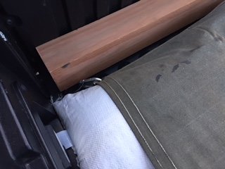

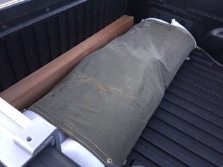

    I have a real simple setup that puts 4 60lb bags of tube sand by the tailgate. It's a canvas tarp that wraps around the bags of sand and is secured to the tie downs with cheap carabiners, the piece of wood is to distrubute the weight of the sand, I didn't have this last year and the tailgate has ever so slightly bowed outward in the center. This has worked well for a couple of years. My problem is that after a couple storms and frost/thaw cycles the additional load of iced up snow has the rear dragging.
