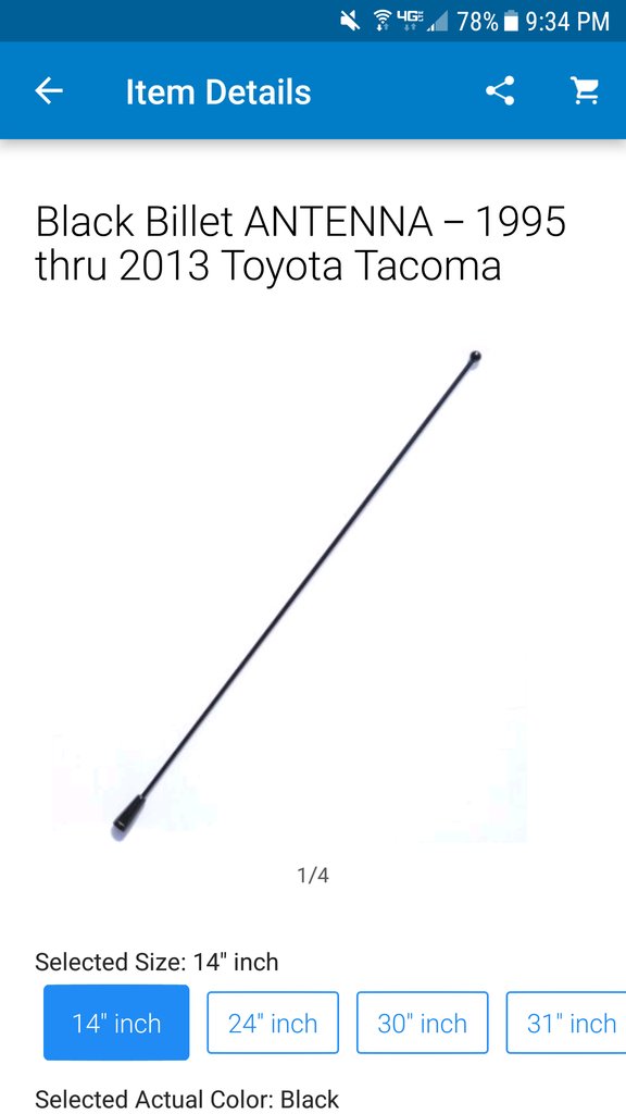

    I have one of these and no complaints. Antennax
