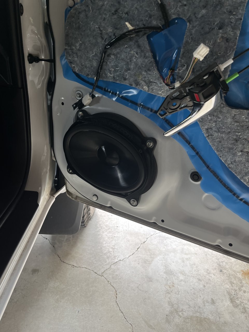

    Installed these infinity reference speakers yesterday. They are 3ohm load. The kit came with tweeters and crossovers but I did not install them since i just installed the DS18 tweeters.
    These infinity 6x9 by harman bring out pieces of a song that I did not hear before. They are clear, but not distorted at higher volumes.
    Truck now sounds like a tiny music hall as it should.
    Also I purchased the metra adapter but it seemed too flimsy. It actually broke on me during install the first try. So I went with the taco tunes heavy duty speaker installation adapter kit. They come with longer screws too so you don’t have to worry about them backing out over time.

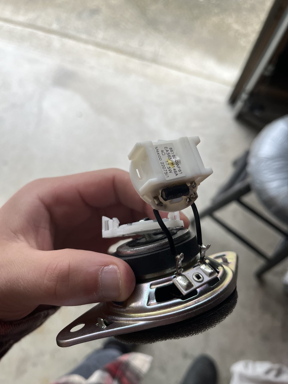

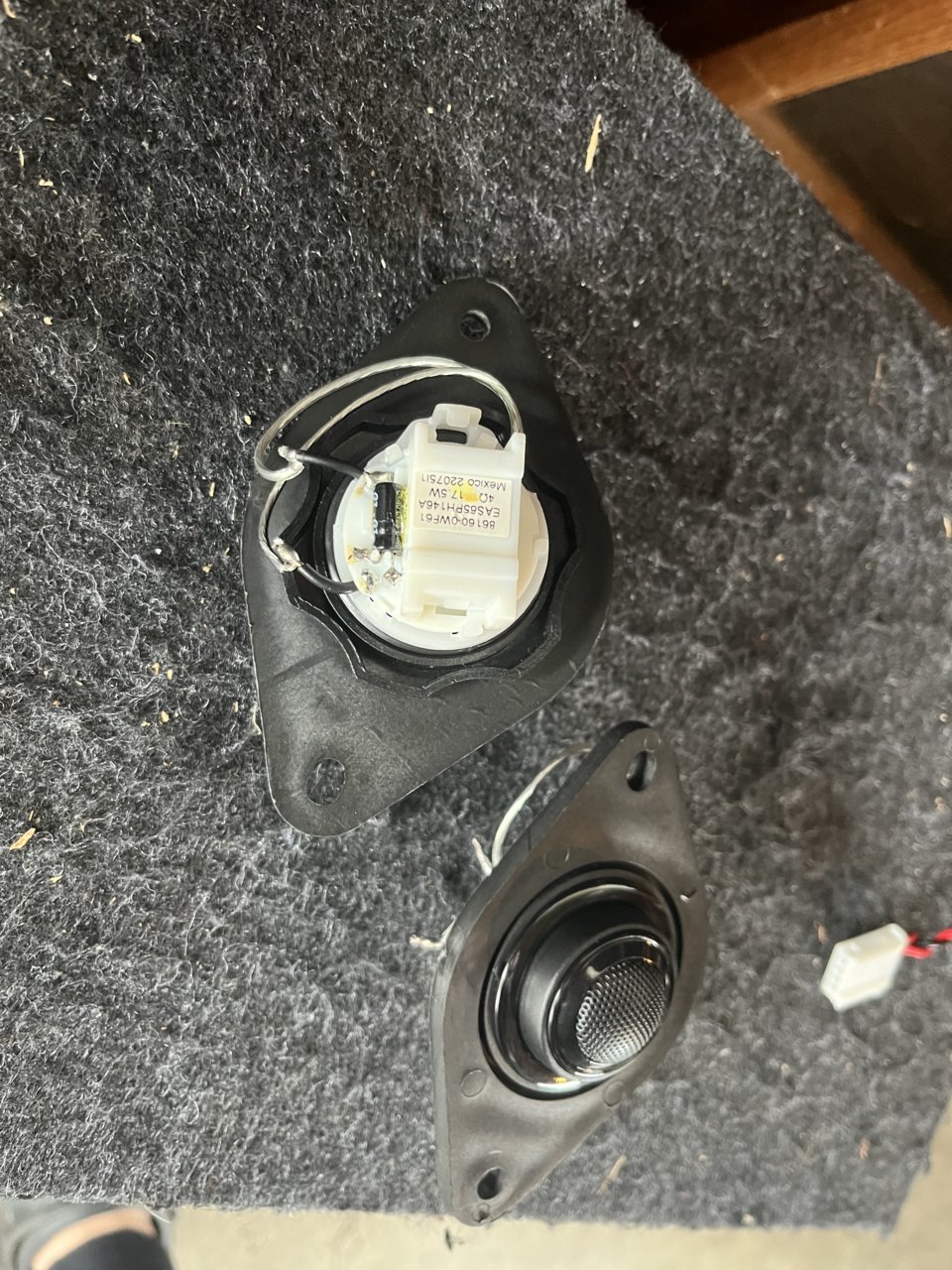

    For those who want to keep the stock sound volume of the tweeters while upgrading the speaker itself: you can remove the resister and wiring harnesses on the stock speakers. Just need to pry up on the plastic connector on the back of the speaker. Inbetween the two pieces of plastic. Underneath there is a screw you take out. Then pry up the glued down harness connector mounting plate. This cross over can then be reused and glued on the back of the new speaker. I noticed the highs of DS18 tweeters to be very loud. Just saying, because my ears are sensitive to this frequency range, I put a small circle cutout of cheap speaker box carpet over the tweeters behind the dash to help muffle the bullet tweeters for the time being. But I do see myself installing these stock crossovers as well. If the DS18 come with crossovers on the back then they don’t put out enough resistance and the sound is too loud. I don’t remember seeing one on the back of them when installing.
    Going to try and install these with the infinity reference tweeters. Should be good once it’s all installed. The treble on my Eq is turned all the way down right now and I feel like it’s drawing sound away from the other speakers as well.

    That's interesting and good info. :thumbsup: First time I've heard anyone complain about the DS18 tweeters (love ours), but everyone's hearing is different of course. They do have a built-in crossover. The frequency response ranges from 1KHz to 20KHz. (More here) Adding additional resistance could lower the volume, but it will also increase the load on the OE non JBL stereo's amp which is designed for 4 ohms. No idea if it would be enough stress to overheat it or make much of a difference though.
    Rather than going to all of that work, if you're still within the return period (30 days for Amazon), I'd suggest replacing them with the PNP Kicker H631SFJ101 tweeters. I say that because that's what I initially installed. They did sound better than stock, but were certainly no louder. After reading other reviews I swapped them out for the DS18s, which as you've found are definitely louder. I like them much better and it seems so do most others, but if they're not what you were hoping for, I'd think the Kickers would be the best option in your case.

    Thanks for sending that Subaru part number and link! I might give those a try if this tweeter doesn’t work out better. It most likely will since it’s a stock head unit and resistor. The speaker takes the rest of the power from the HU.
    i am weird about what I install in my cars.. I am definitely a DIY reuse materials if they’re good kind of guy. I do have a kicker 500.1 amp also, so the head unit isn’t sending much power to the doors for bass, should free up some power for the highs and mods without warming the unit up too much.
    The DS18 tweeters are really clear sounding which I like. When I was testing the tweeters on a home stereo system with and without the resistor, a lot of the background noise was removed and they sounded perfect to my ear so I’m excited to swap them out again.

    They sound amazing btw. I can turn the treble back up again. Sounds just like stock but much cleaner and clear. 100/100.
