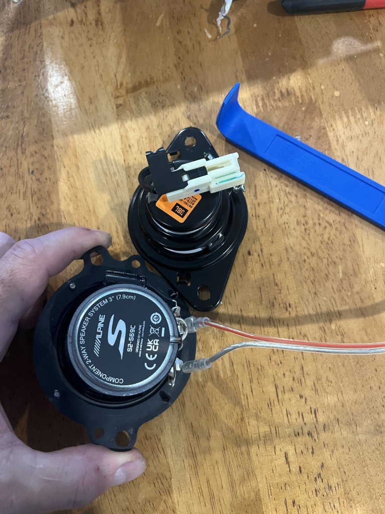

    My 2 cents. Get the alpine 3inch. Anything is better but these fit with an adapter plate and no trimming. Don’t be Worried too much about 2ohm 4ohm. I didn’t notice much difference. Just don’t put a low sensitivity speaker that needs 500 watts.

    Where did you get the adapter for the Alpine tweeters? I’m searching for a set for my setup.
