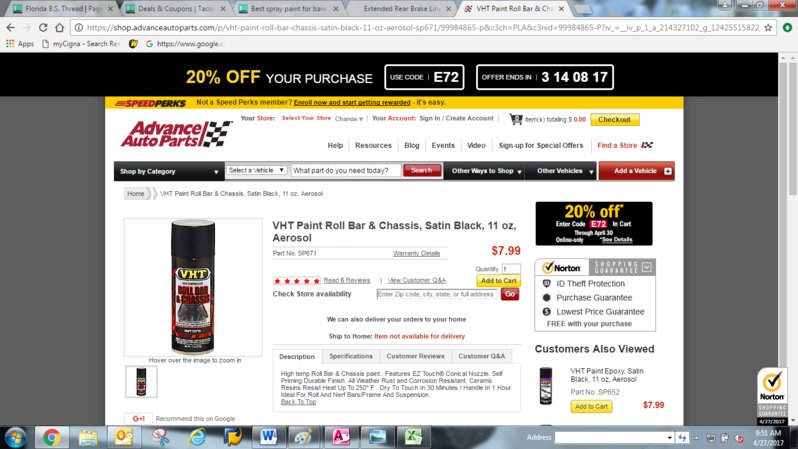

    I bought some of this havnt really used it on my truck , but it has great reviews its a paint and primer in one.

    VHT paints from the parts store. They have a roll bar/chassis paint and an epoxy paint. Both are self priming. You won't be disappointed with either. MUCH better than an enamel paint.

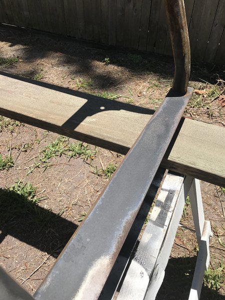

    VHT just used it stuff is amazing
