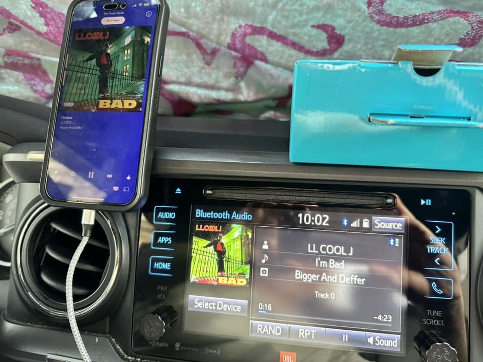

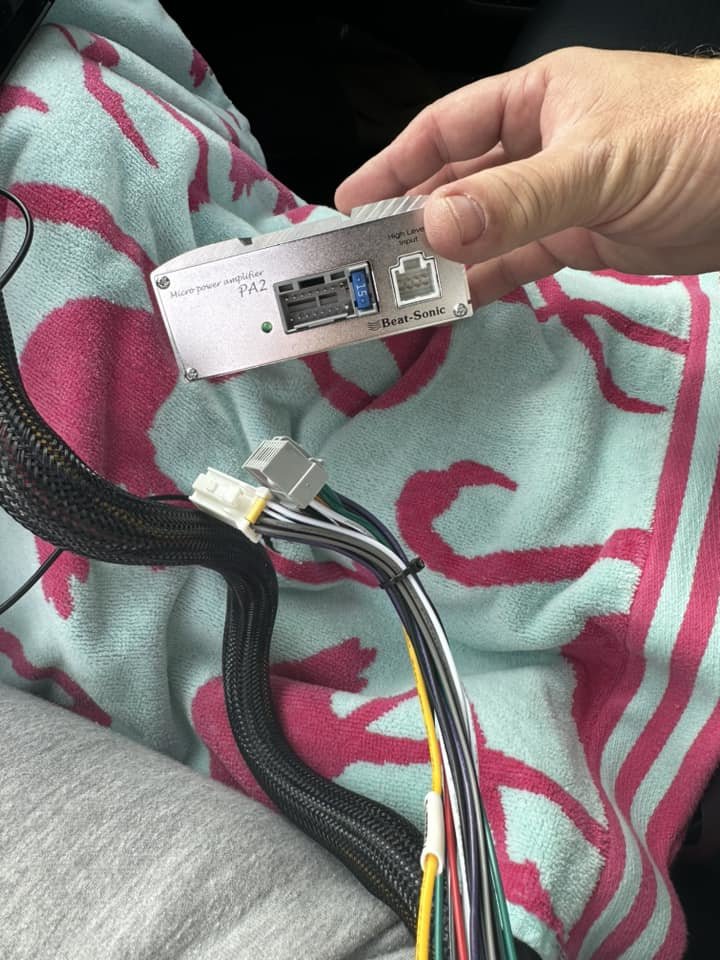

    BEST $269 I haver ever spent!

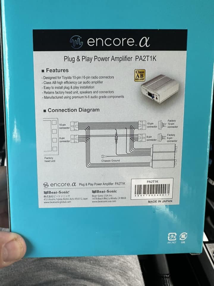

    Specifically how does this work with the factory JBL system that you say you have? Because the encore amp is only a 4 channel, and the JBL system uses an 8 channel amp...

    It works extremely well, I was ready to soend thousands upgrading the Jbl and took a chance with this and I am Super happy with the sound quality!
    Also is much louder and the Sub now has a nice punch!

    So it didn't change the amplification of the system, it just re-eq-ed the system

    Can't watch a video from where I'm at in the voting line, but can tell you that from the diagram you posted originally, if you're in the dash on a JBL system, you're in the wrong spot to fuss with the amp.

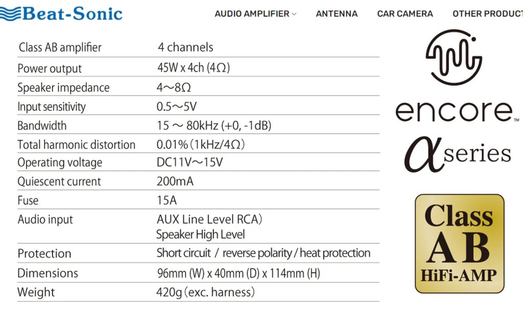

    Class AB amp ? lots of wasted energy there, but only a 15 amp fuse.
    A 15 amp fuse, so probably only draws 7-10 amps max, so 84 to 120 watts max consumed, - %25 because class AB efficiency loss, so between 59 - 90 watts total signal output, divided by 4 channels = 14 to 22.5 watts max out to each speaker at 1kHz only (which contradicts the spec sheet) of 15-80kHz ? (15,000Hz to 80,000Hz) ?
    Humans can only hear up to around 20,000Hz and that's if you have excellent hearing.
    Last, only 18 ounces total weight?
    My guess, the gain control makes it reach max out with lower volume number displayed on the Head Unit.
    Must be Magic...
    or its Friday again?

    I reached out to Beat Sonic to ask about the rms output of this amp. They said it puts out 23W at 14.4V per channel.

    That's about what I figured. And that's at 14.4 volts? I think my truck shows around 13.5 / 13.6 volts when running.
    The fun part (to me) is where some claim to be using that amp and are So Impressed with it...
