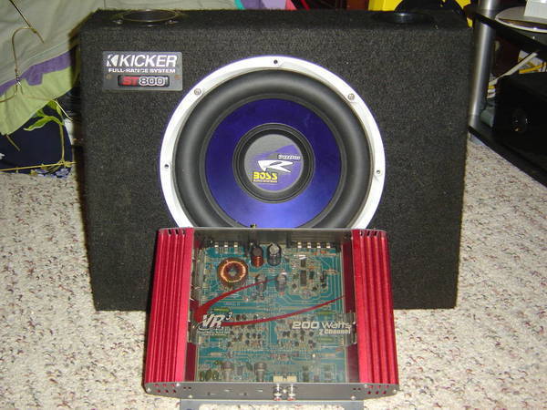

    Cool! I think I may cut out my jack holder and get a box with these deminsoins and put it behind the passenger seat. That way I will have the air space and can put a 12'' in it. I may could use this box, just seal up the port. What do you think? 17.75in long. 13in high. 13.5in sub face. 4in top depth, and 7in bottom depth.
