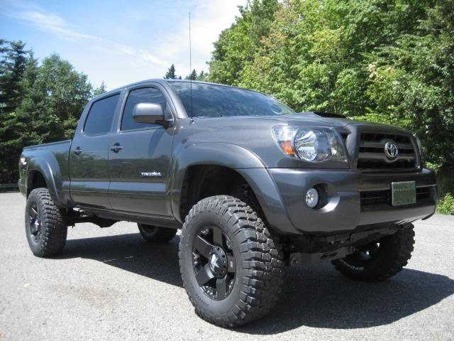

    Lifted 09 TRD Sport
    6" Pro Comp Lift, 35" BFG KM2's on KMC XD Series Rockstars, Front Windows Tinted to Match Back, AEM Brute Force Air Intake, 40 Series Flowmaster Muffler, Bilstein 5100 Shocks
    I just installed a 6" Pro Comp last weekend. The kit was very well put together. Complete and labeled nicely. It went on without any troubles...
    I have 35x12.5's on a 18" wheel. There was some minor trimming required on the front.... no big deal.
    I have not re-geared yet... but plan on going with 488's pretty soon.
    The 6" lift kits for our trucks are all very similar.....My friend has the Fabtech.

    Lifted 09 TRD Sport
    I think there is still plenty of power, but to bring it back to stock... gears would be nice. 4.88's is what I want to go with. The general
    "rule of thumb" is to over-gear just a touch.
