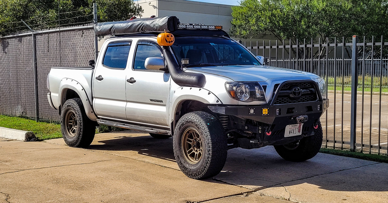

    Some E rated tires have very different construction in regards to material. Most of the time you can mitigate discomfort by airing down.
    When I had my 33's with no additional weight, I was running about 32-34psi.
    With additional armor and the gear I have I currently run 38psi.
    Not sure how alot of people think it is uncomfortable because it is nearly as cushy as stock without all of the bouncing/bouncing of the unloaded stock bed. Maybe just older folks who could care less for stiffer suspension/tires.
    Abs activation may be another issue altogether. Did you recalibrate VSC?
    I drive relatively spiritedly. About 85 cruising. I take 90* highway ramps going 75. Normal turns on a 40 speed limit I will take a turn goog 35-40. Never had an issue with ABS.
    Heres a pic of the setup.

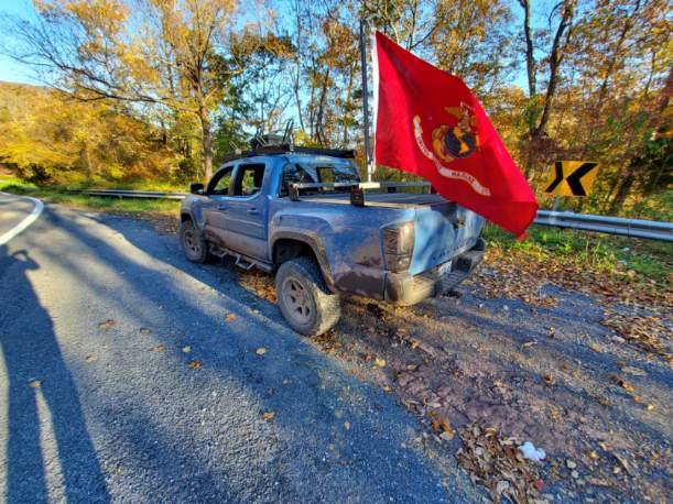

    INSTAGRAM: JWIZZMASTERWET #SUPERCHARGED #METALAF #HARAMBE PERFORMANCE/FUNCTIONAL UPGRADES: -URD Supercharger -Sound Deadened cabin with Noico Solutions 80mil -Skar Audio full pro-audio setup (2xtweeters, 4xmids, 3x10inSUB) SUSPENSION/LIFT/TIRES: -ICON Stage 4 (650lb coils) -ICON RXT Leaf Pack (Option 3), -285/65/18 BFG KO2 FUNCTIONAL(eye candy?): -Rave OffRoad roof rack -Rave OffRoad 43in light bar (amber + white) -Rigid led PODs (x4) (mounted along roof rack) -Westin Side Steps -BakFlip tri-fold tonneau cover -VOODOO Fabrications hi-rise crossbars -Pelican Case loaded with recovery gear(mounted to roof rack) -Smittybilt gen 2 overlander tent -Smittybilt recovery boards -HI-Lift Jack COSMETIC AND NON-PERFORMANCE UPGRADES: -Custom front grill -Bumper Shellz rear bumber cover -Meso Customs full interior chrome delete -Interior of cabin lined with sound deadening material (Noico Solutions 80mil) -Rear seat delete and custom shelf (home-made) AUDIO (SKAR AUDIO): -2x pro audio tweeters, 4x pro audio mids, 3x 10in subwoofers (SKAR AUDIO) -1x RP-1200 amplifier (mids), 1x RP-2000 amplifier (subs), 1x SK-400 amplifier (tweeters) (SKAR AUDIO) -Audio crossover
    I have the ICON stage 4 + ICON RXT Leaf pack at option 3. I'm also running "E" rated KO2s 285/65r18 on an 18x9 rim with 0 offset. My truck is supercharged with the URD kit for the 3rd gen tacomas, but I can assure you the ride quality was great even before the power gain of the supercharger. I went straight from the stock Goodyear tires to these KO2s, so I only have experience with those 2 tire setups.
    The ICON stage 4 UCA allows for max caster adjustment and a few other alignment specs to be implemented, so I'm sure that helps out a lot. I personally love this setup and would recommend it. I don't have experience with KING or FOX, but I know those 2 are valved differently than ICON
