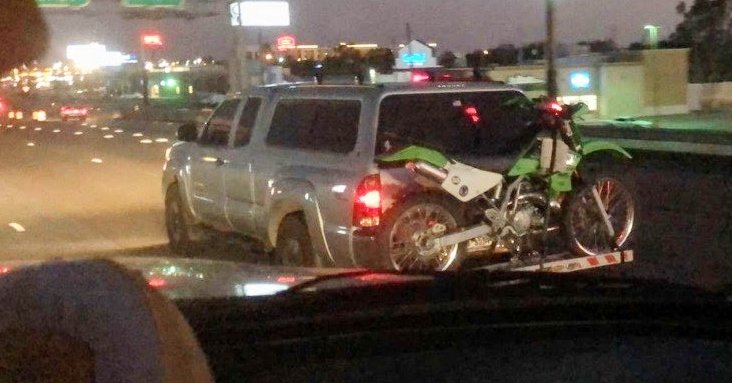

    Going to be interested with what you decide to do for your suspension. My towing situation is very similar to yours. Just this past week I was pretty loaded up with some camping gear under my Leer 100R cap and my dirt bike on the trailer hitch carrier. I was sagging more that I liked so when I got back home I've been on the internet for a couple of days trying to figure out a solution. I've been running the Roadmaster Active Suspension (RAS) since right after I bought the truck in 2012. So the RAS has been on before and after the leaf spring recall and either I'm stuffing more gear in the back or just never noticed just how much sag was going on.
    Here's a picture a friend of my youngest son took as I just got back in town. The sag isn't as bad because most of my supplies were used up and I loaded (stuffed) quite a bit in the cab.
    Getting a lot of ideas from old threads on this site, I researched everything from Helwig helper springs, SumoSprings, Timbren SES kit (suspension enhancement system) air bags and replacing the leaf packs. Since I do this about 6 times a year or pull either my utility trailer with a couple of bikes, I don't want stiffen the suspension so much that it makes for a harsh ride.
    Staying tuned in on this thread.
