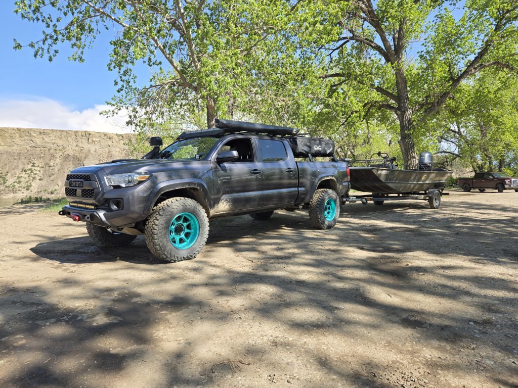

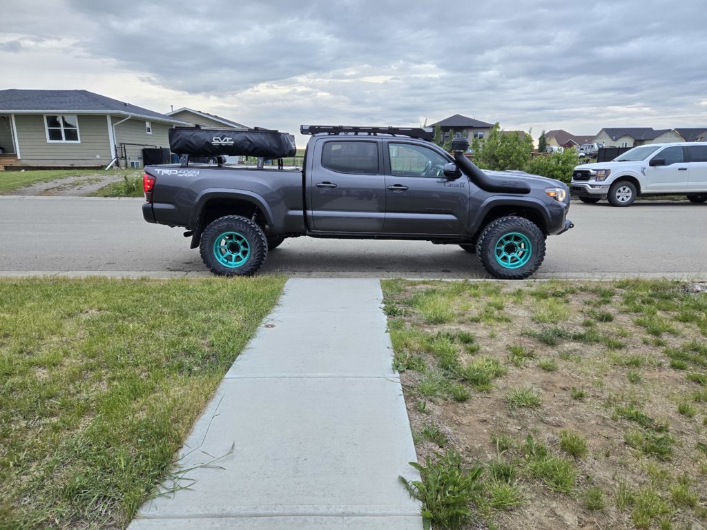

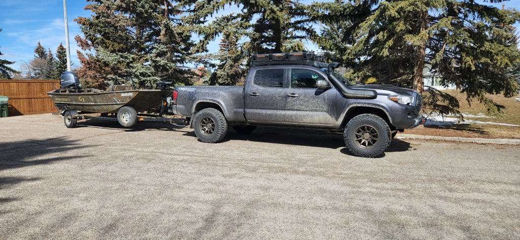

    Are you on a dcsb/aclb or dclb? I found there's a major discrepancy between the load capacity of leaf packs depending on the vehicle layout. Dobinsons does account for this on their site. And when your looking at springs remember most of the advertised capacities are at x lift.
    I would upgrade the pack with air bags potentially. I had ome 111's and with either of my set ups it wasn't enough to support it well and even less so when towing.
    I strive for a 2/2 lift it only runs level when fully loaded and maintaing that rake as much as possible really does make the truck drive much better.
    Dobinsons 112 with around 600lbs
    Ome 111 with about 200lbs
    Dobinsons 112 with a full load plus the boat
    Ome 111's only weight was the bed cover
    Tocamo, Relaxinslax and MGMDesertTaco like this.
