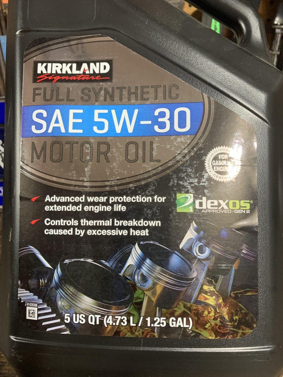

    I've been using Costco oil for a while. The last I bought was about $25 for two 5-quart jugs. I think it is now $35 for 10 quarts. And I've done 10,000-mile oil changes since new. That was 15 years and 228,000 miles ago. Truck still runs like new, and I've never added a drop of oil between changes.
    A lot of guys overthink this stuff. Which oil doesn't matter and you can go a lot longer between changes than a lot of guys think. The key is to keep oil in it. My mechanic has seen a car go 100,000+ miles with no oil changes. And even after that the engine only died because they let it run out of oil.

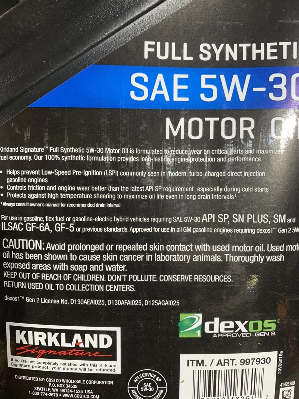

    This is great oil and it meets or exceeds Toyota’s specs. Read the back panel but if it makes you feel better spending more money for some fancy shmancy big name oil then do it.

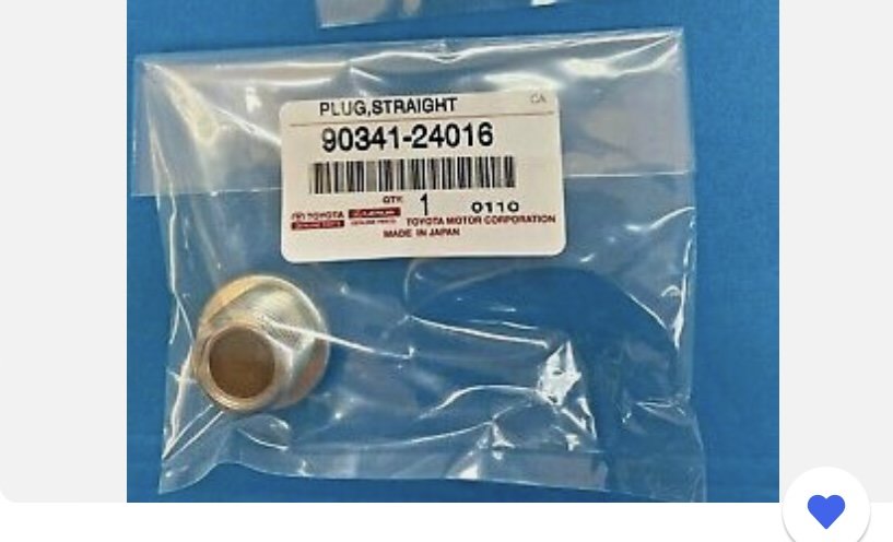

    I assume you’re a new Taco owner here’s a cpl bones to chew on at your leisure and welcome aboard:thumbsup:
    and when you service your front diff, put this bad boy in its place (Lexus/standard bolt), the hex bolt on your front diff will strip in time, best to replace with a standard whenever your next servicing is, if it hasn’t already been replaced that is.
