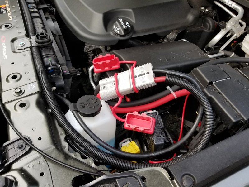

    I use Anderson connectors, I have the winch plus a jumper cable set and well make a cable for a refrigerator if I buy one.
