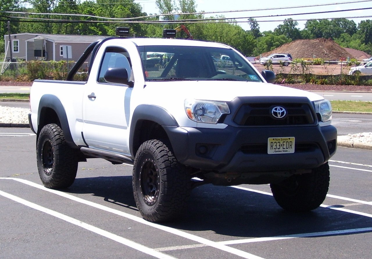

    Have you thought about 305/65/17 tires? I ran them on the 17x8.5 wheels and had minimal rub at full lock. I think with your 17x9 -38 you'll be rubbing regardless of the tire width.

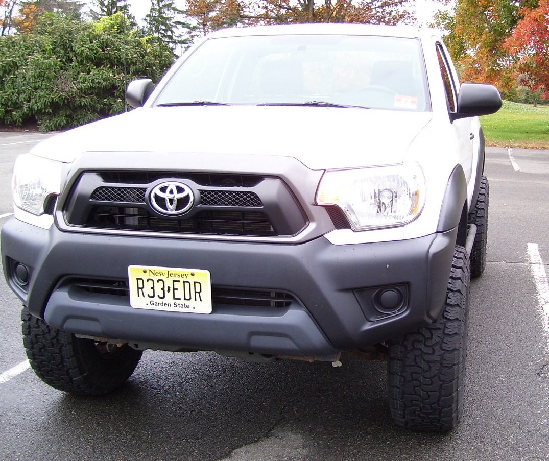

    Here are the 305/65/17 on the 17x8.5 -10 wheels. If you went with them and the 17x9 -38 they would stick out almost 1.5" more just to give you a reference.
