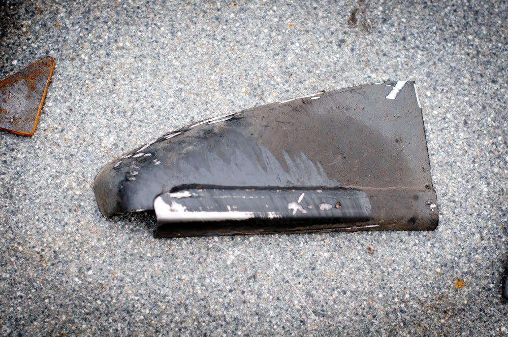

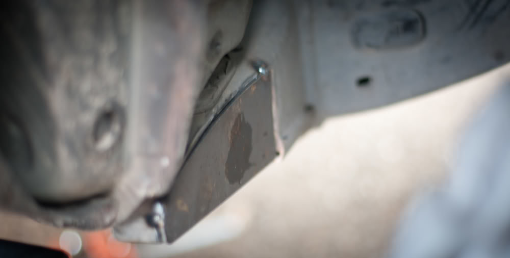

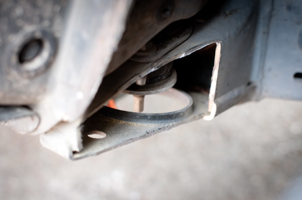

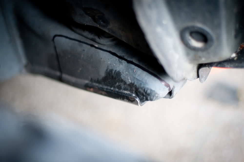

    So with tires that large on our trucks, they tend to rub on things. The two most common things are to the rear of the wheel well. One is the body mount, which needs to be chopped back, and the other is the pinch weld which has to be hammered back and sealed up.
    This is taken from this thread.
    https://www.tacomaworld.com/threads/b-a-m-f-cmc-plates-cab-mount-chop.192527/
    This thread discusses hammering your pinch weld.
    https://www.tacomaworld.com/threads...lat-with-a-sledge-hammer-lets-discuss.425850/
