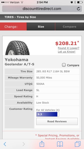

    265/65/17- 30.6x10.4
    275/65/17- 31.1x10.8
    285/65/17- 31.6x11.2
    Just my .02 if you're looking for wider.

    The wider the better! Thank you for the helpful info and graphic! Definitely gonna look into the 285s!
