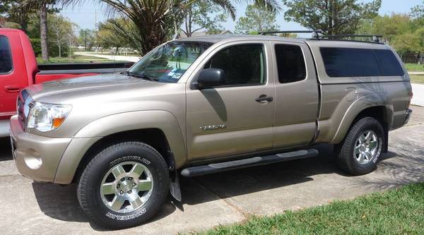

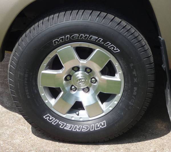

    I like the Michelin LTX M/S2 tires that I put on my truck. Like you, I do not do any off road driving. These tires have great grip on wet roads. With the stock tires, with just a little bit of gas, the tires would start to slip, but with these tires MS2, I have not been able to get them to slip in wet weather even when I punch it to the floor.
    I am thinking that you get a bit of rain up in Seattle.
    The LTX M/S2 is Michelin’s Highway All-Season light truck tire developed to combine long tread life with all-season capabilities for vans, pickups and sport utility vehicles, as well as for commercial vans, shuttles and chassis cab vehicles using light truck tire sizes. The LTX M/S2 is designed to combine a smooth, quiet ride with year-round traction in dry, wet and wintry conditions, including in light snow. Compared to the original LTX M/S, the LTX M/S2 is an evolution in looks…and a leap forward in performance.
    The LTX M/S2 molds a long wearing, silica-enhanced all-season compound into a tread profile featuring Michelin’s MaxTouch Construction to produce a contact patch that promotes reliable traction and long wear by evenly distributing acceleration, braking and cornering forces. A symmetric tread design of stable independent tread blocks featuring high-density 3-D Active Sipes delivers all-season traction on dry roads and in inclement weather. Four wide circumferential channels, multiple lateral grooves and open shoulder slots promote lateral water evacuation to enhance wet traction and stopping performance.
    The tire’s internal structure includes twin steel belts (three steel belts in Load Range D and Load Range E sizes) to provide the strength and durability needed to handle heavy loads.
    NOTE: The LTX M/S2 Highway All-Season tire is NOT a dedicated winter / snow tire. It does NOT meet the severe snow traction requirements and is NOT branded with the mountain/snowflake symbol.
