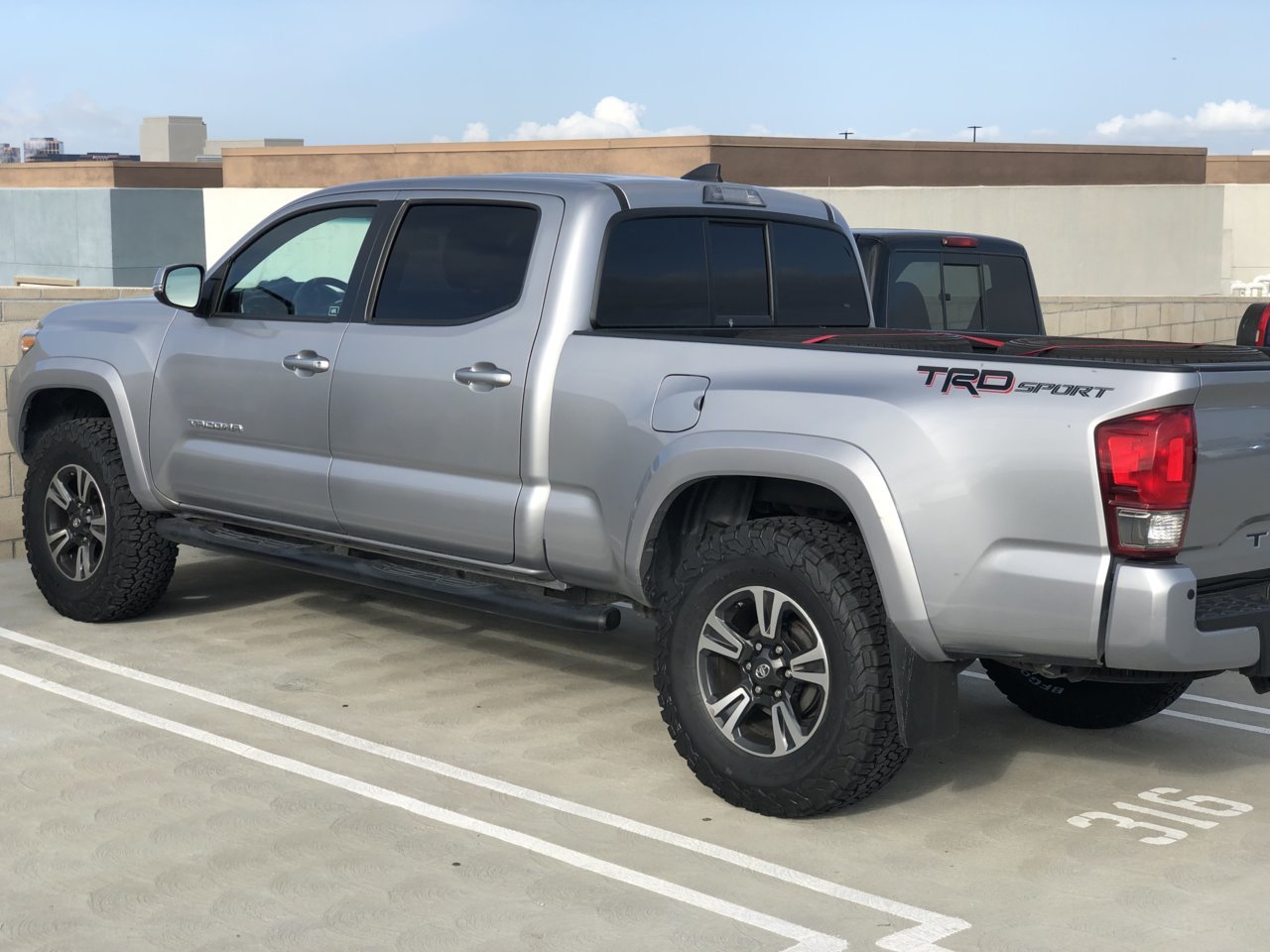

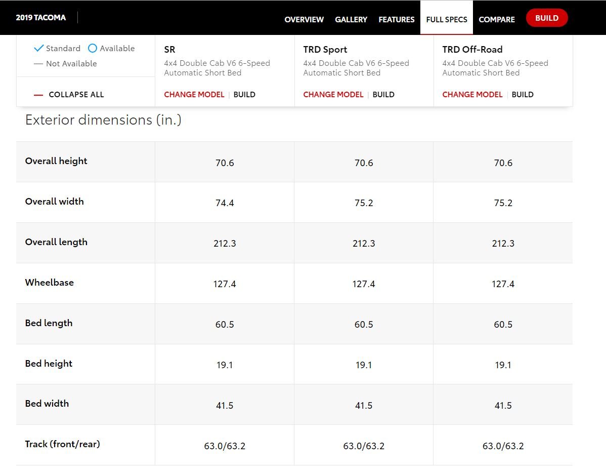

    I go by what Toyota lists on their website. They list all Tacoma models as same height and ground clearance except the TRD Pro. I can't speak for every single Tacoma that might be affected by endless individual things such as Tire pressure, tire brand, tire size, cargo weight, suspension upgrades, tire wear tread depth

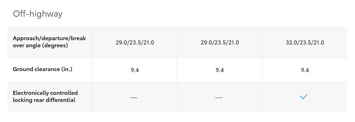

    The Off-Road Approach is different because it does not have the front air dam skirt

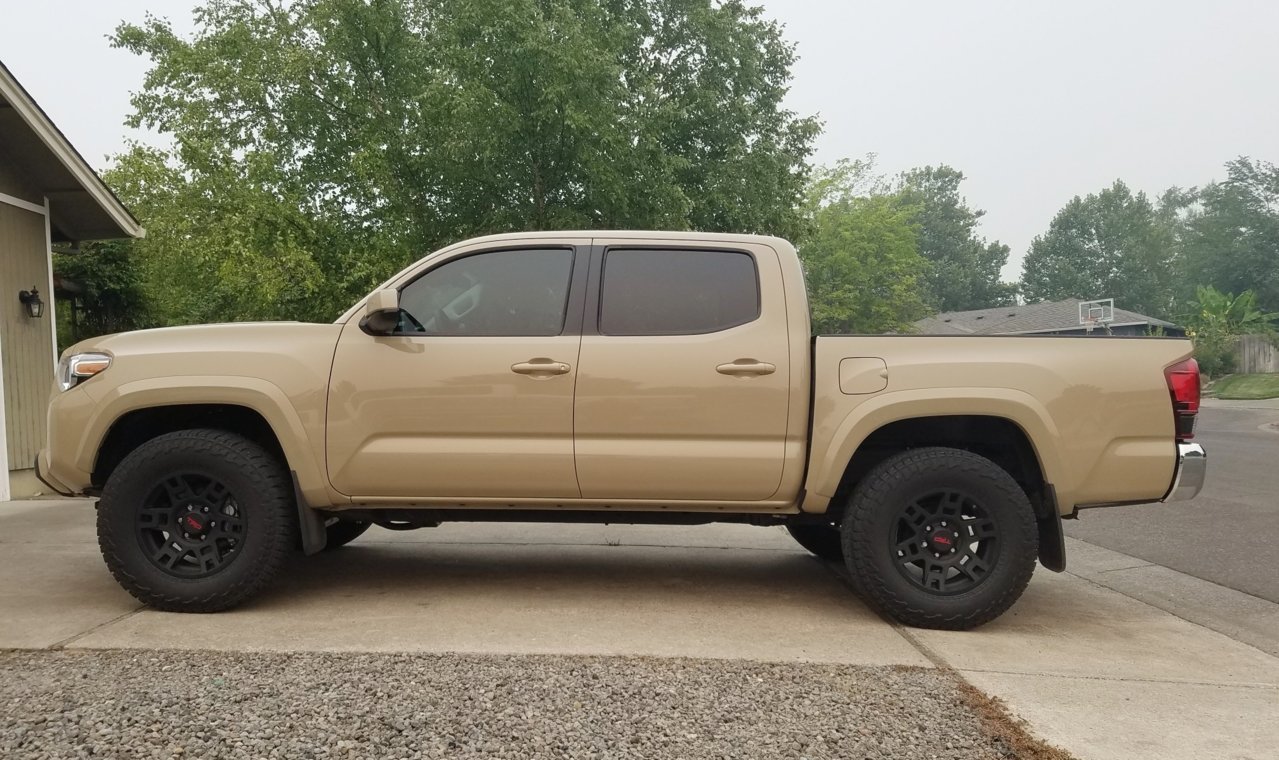

    Just get some Falken Wildpeaks A/T3W in 265/75-16 or 265/70-17 it will correct your speedometer and are fantastic tires for everything.

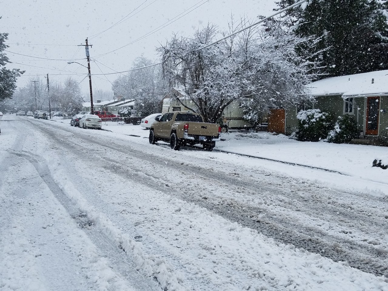

    Resized_20190226_153654_5091.jpg Fantastic in Snow
