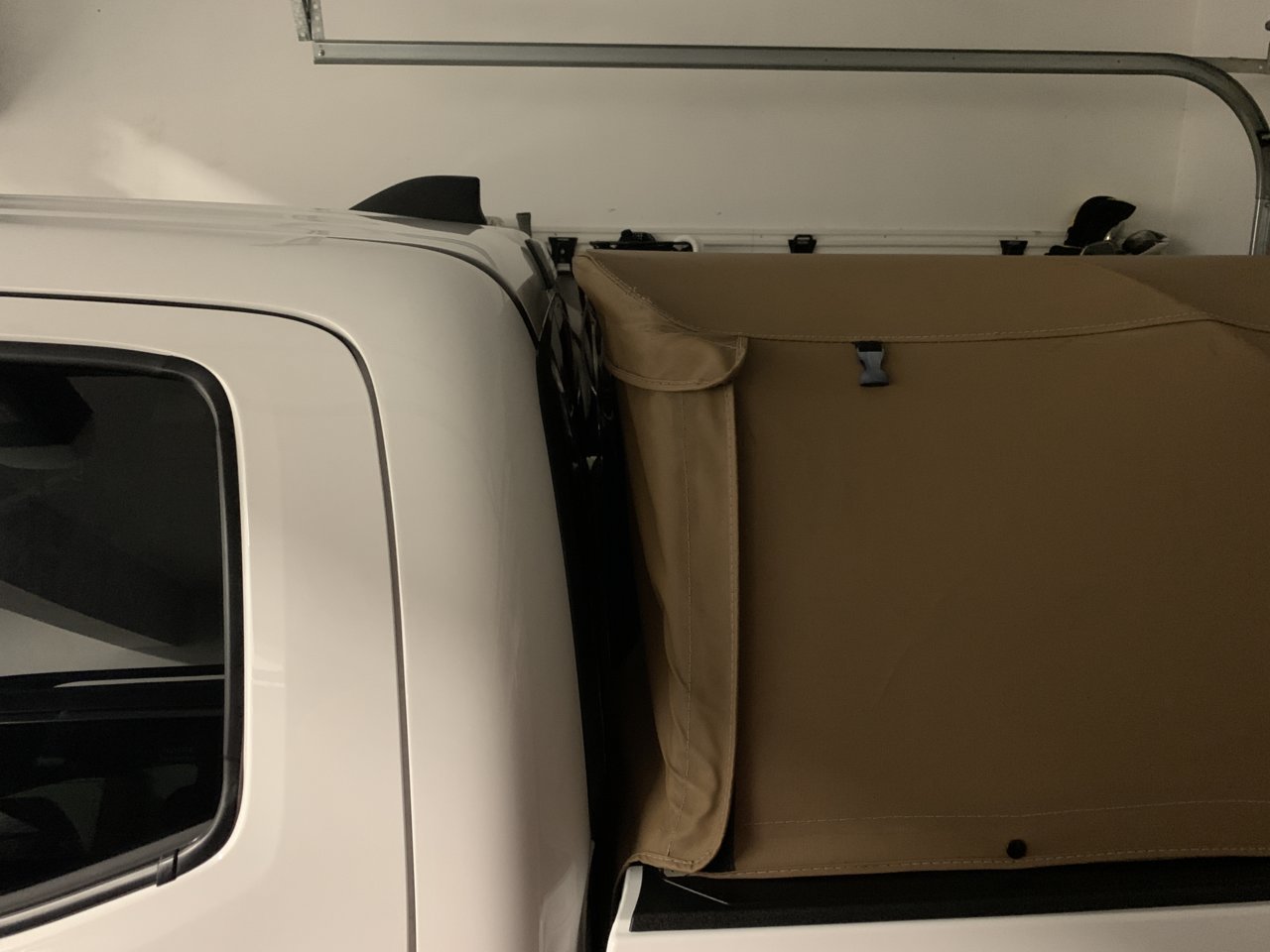

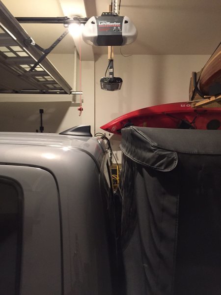

    There’s two versions of the softopper made for the 2nd gen. The older version for the 2nd gen sits a bit high, just above the cab when on the 2nd gen. The newer version of the softopper that was made for the 2nd gen sits level or a bit lower than the cab. I was told that the newer version is basically the same as the third gen.
    if you have any pictures it’s quite easy to tell which model it is.
  4. Dec 28, 2020 at 8:34 PM
    HLTaco
    HLTaco Well-Known Member
    Jun 2, 2019
    #295179
    243
    Huy
    NorCal
    2020 Tacoma Off-Road 4x4
    here’s a pic of a 3rd gen with an older 2nd gen softopper. It’s sits high.
    Here’s my softopper. It was made for a 2nd gen as well, but is a newer model and sits lower. I did have to change the back window as the 2nd gen model doesn’t fit quite right.996AF81A-94E6-4878-98E4-64DDAF7A4D3B.jpg
