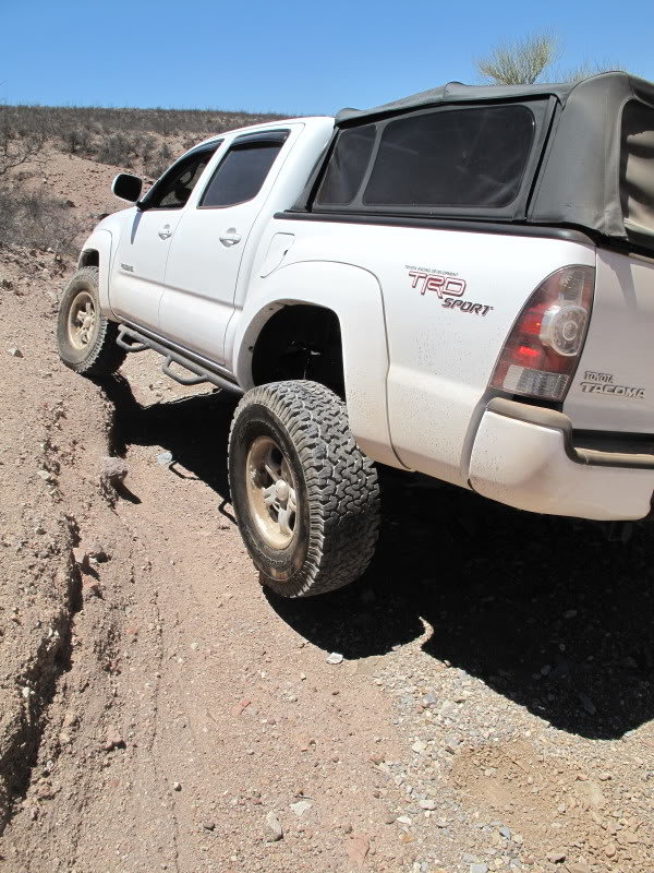

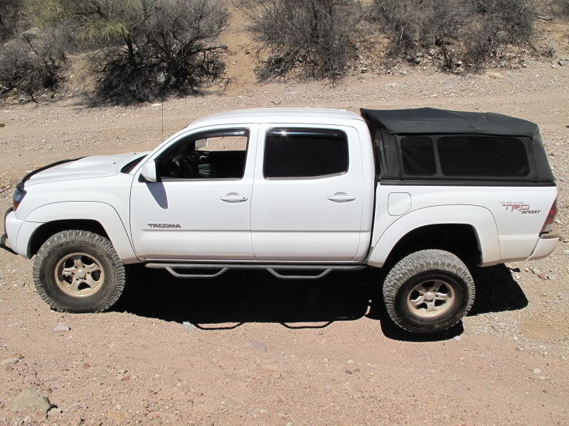

    Hey guys, just figured out there is a local side to this website! Any opinions on the best top super top (like pictures below) and how it handles in the az heat? Is it easy to take on and off? Ive seen a few in the area (one on a red taco at REI on southern and priest) and i am wondering if its for me? Does it do well offroad? Easy to clean? Sorry for the questions! I figure ive done so many purchases without research i might as well start some good habits now... Thanks guys![​IMG]

    762x51taco has one. I won't speak for him, but the thing looks pretty sweet and is a lot easier to deal with than a camper shell.

    Don't get it if you have a full-size bed. The DC ones seem to be fine. The ones for the 6' bed have problems. Mine was a piece of crap. Two of the riveted snaps popped out during the initial installation, and then the unit failed on the freeway coming home from Flagstaff after <1 month of use, damaging my truck and almost causing an accident as it ripped itself from the truck and jettisoned into the air in front of oncoming traffic. I've seen other pictures online of the same thing happening to others with the 6' bed. There is a design flaw with how it seals to the front of the truck bed, it's just Velcro and two plastic clips. The manufacturer even admitted that this was not the first time they had seen this, and acknowledged (verbally) that the unit was not improperly installed.

    the people at bestop are very nice and understannding. I have a bestop and the first one they sent had something sewn on wrong and they overnighted me a brand new set up and gave me extra clamps for the bed rails which woulda been like another $20-$30?
    As far as how it handles the heat i cant compare CA to AZ but it is much easier to put up and down and put on the windows too with the heat. When you wash it you want to just use a sponge and wash it just like you would the rest of the truck, just a little more gentle. I wouldnt go thru a car wash with it though. Just my .02 cents
    So to answer everything. It is for you, its great having the option of putting it up and down within 2 minutes. not difficult to clean. Again i dont have the same weather but i couldnt see it being affected dramatically from the Az weather.

    Josh, why you gotta be a party pooper. I have one and love it. I had the same problem that Josh did and that was that the front kept pulling off the velcro and flapping and banging against my window (HARD) at anything over 60mph. Unfortunatly his finally turned into a kite and took flight. I fixed my problem with a $5 piece of flat bar from home depot and a few screws and wing nuts. Just put the flat bar ontop of the bestop where it velcros down, drill 4-5 small holes into the barstock, bestop velcro (the top as well) and the
    bedrail. Then put the screws up through the holes and tighten the wing nuts down. Problem solved.
    My bestop has held up well here in Arizona. Because of the heat they tend to stretch and sag just a little bit but thats to be expected in 110 degree heat. Other than that, I love mine.
