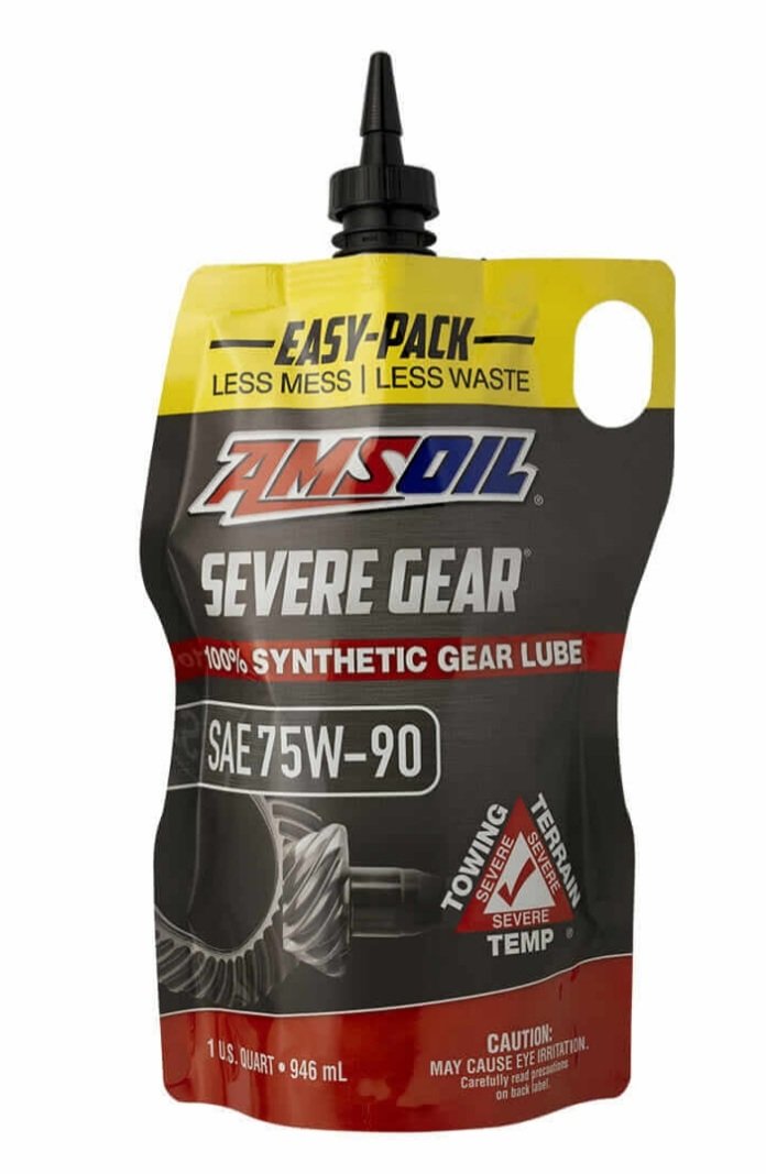

    Amsoil gear oil in rear and front diff. Being that's in a squeeze pouch makes easy too , Toyota OEM in Transmission and transfer case. Engine oil I like Mobil 1 Extended Service, ofcourse synthetic 0w20
    JustJon, KWB17, decaustin and 4 others like this.
