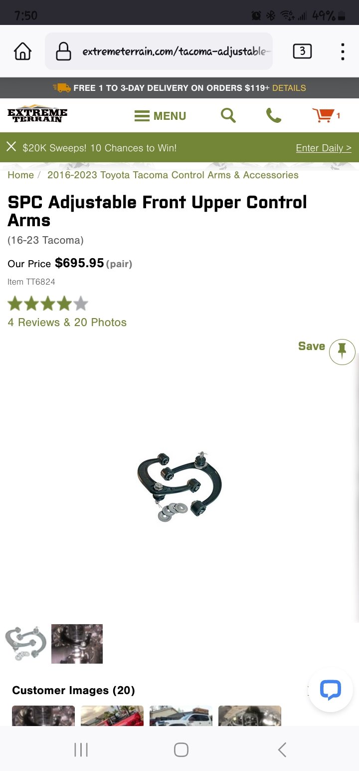

    Im reading not very good feedback about spc and their ball joint. Some people have had good customer experience warranty,but also a good handful of people had bad experience.

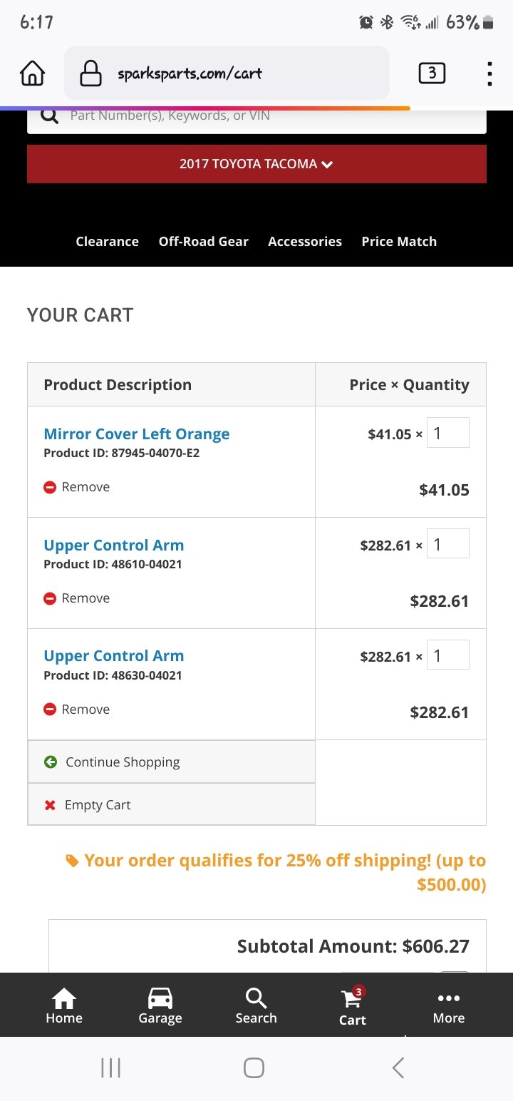

    I got 230k+ miles out of OEM. This a good price minus the mirror cap
