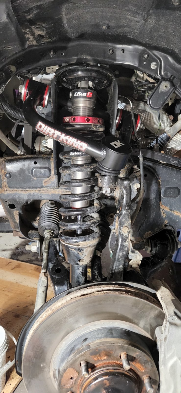

    I have a year on my dirt kings. And so far it's been a set and forget item. I greased the poly bushings once since install and have no complaints.
    Current set up is 295's on a -25 with a cmc no rubbing and good wear pattern so the alignment t has been good
