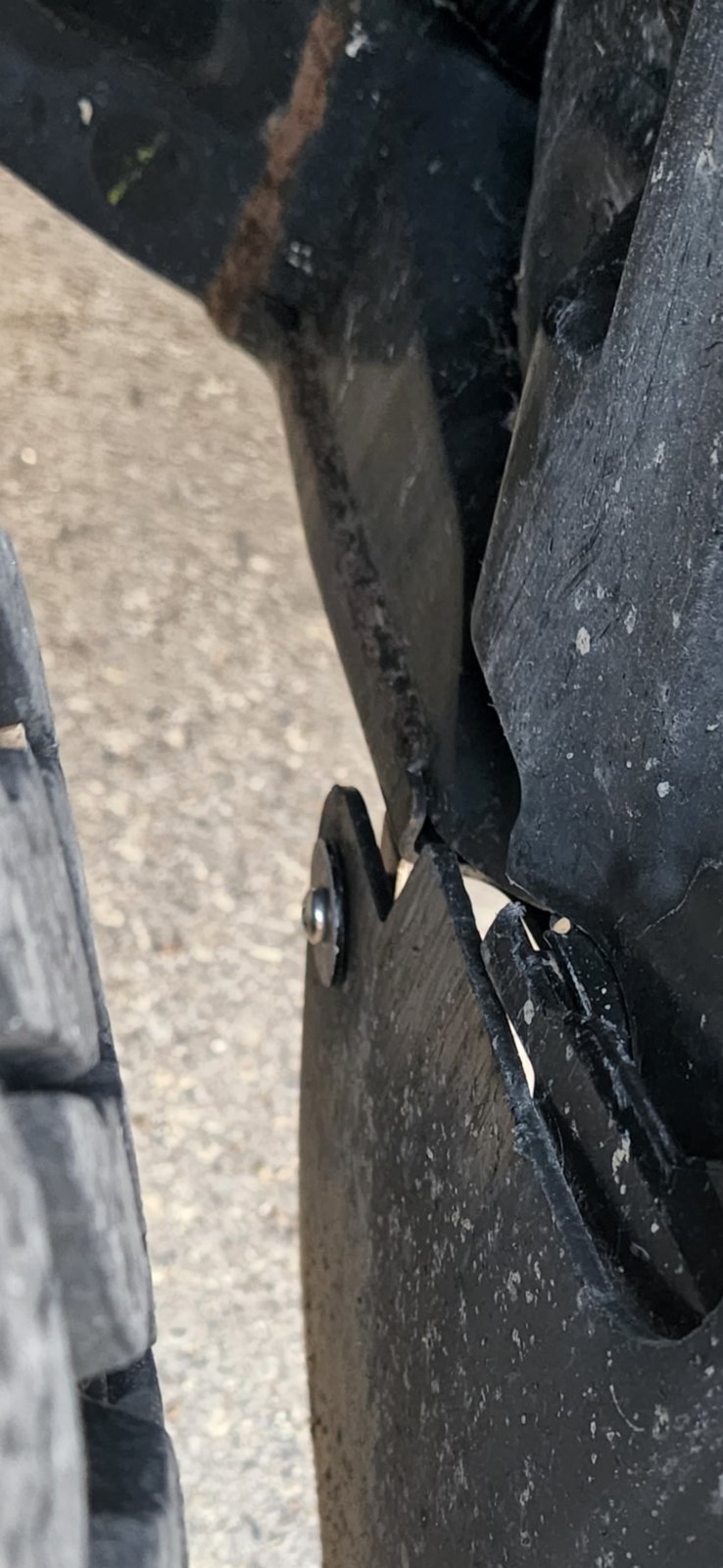

  12. Feb 21, 2024 at 7:51 AM
    #32
    Veet-88
    Veet-88 Well-Known Member
    May 21, 2015
    #155792
    1,734
    18 Tacoma DCLB sport
    You can see here where I would touch the mud flap but no wear lines on the cab mount. Later on I built a new bracket to move the mud flap back a bit and that was mo longer a problem
