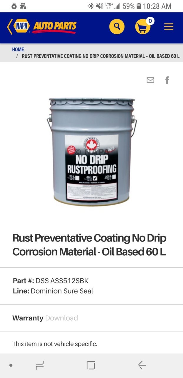

    The BEST products are the no drip oil based amber undercoatings (similar to fluid film). I use a product from napa (name escapes me) it sprays easily with an undercoat gun and doesnt drip. It continues to creep after application and has a much better retention rate than watery products. During the cold it firms up much better so application during warmer months is advised so it creeps.

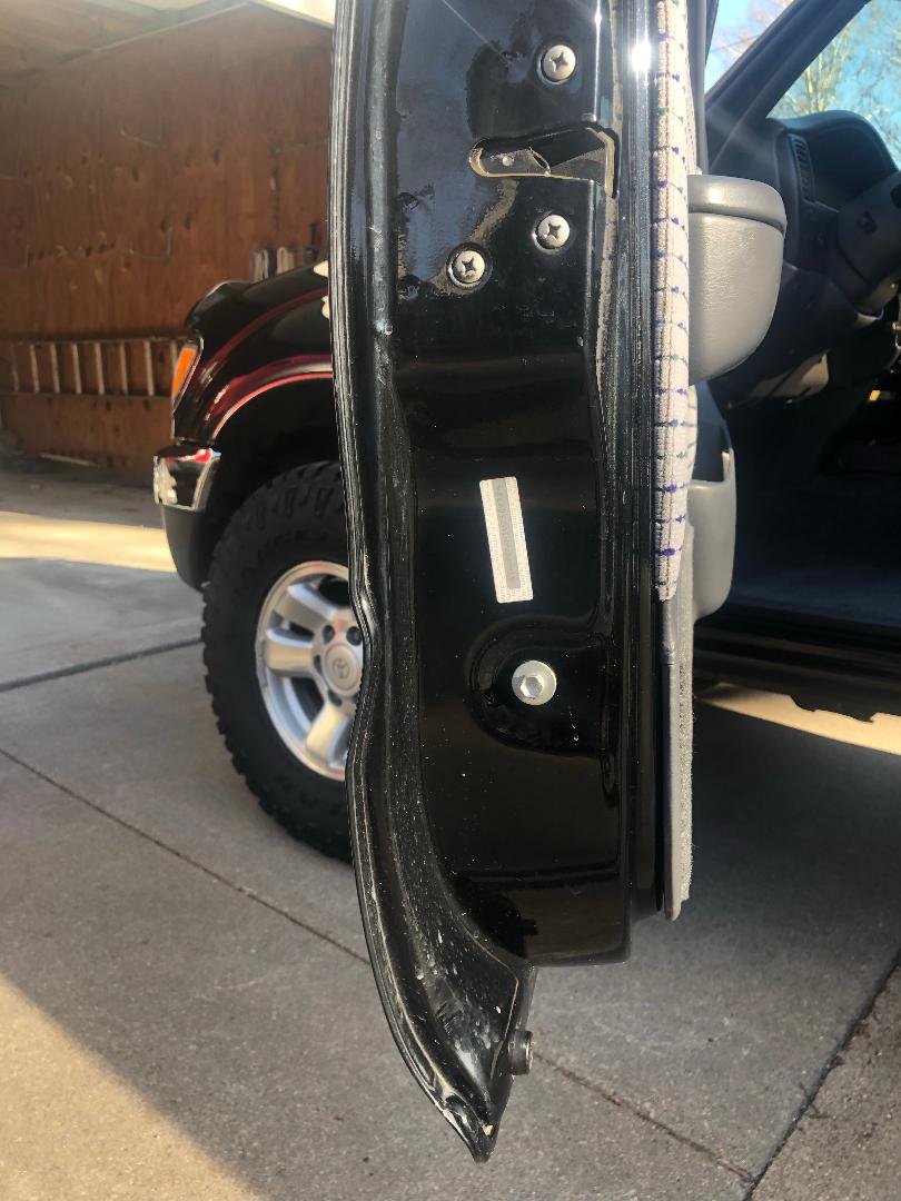

    the local krown applier here in central USA told me he was going to need to drill my doors and i just shook my head and quietly walked away
    i have really super nice doors i think from slaving every winter 2+ decades to keep em clean!
    just some water spots and dusty on black

    There is ZERO need to drill anything.
    You can access the entire inner door panel from the top plug and the bottom 3 drain holes. I remove my door panels once every 2 years. it takes 5 minutes per side.
    Rockers and canlb corners are accessible through the factory rubber plugs! Easy breezy.

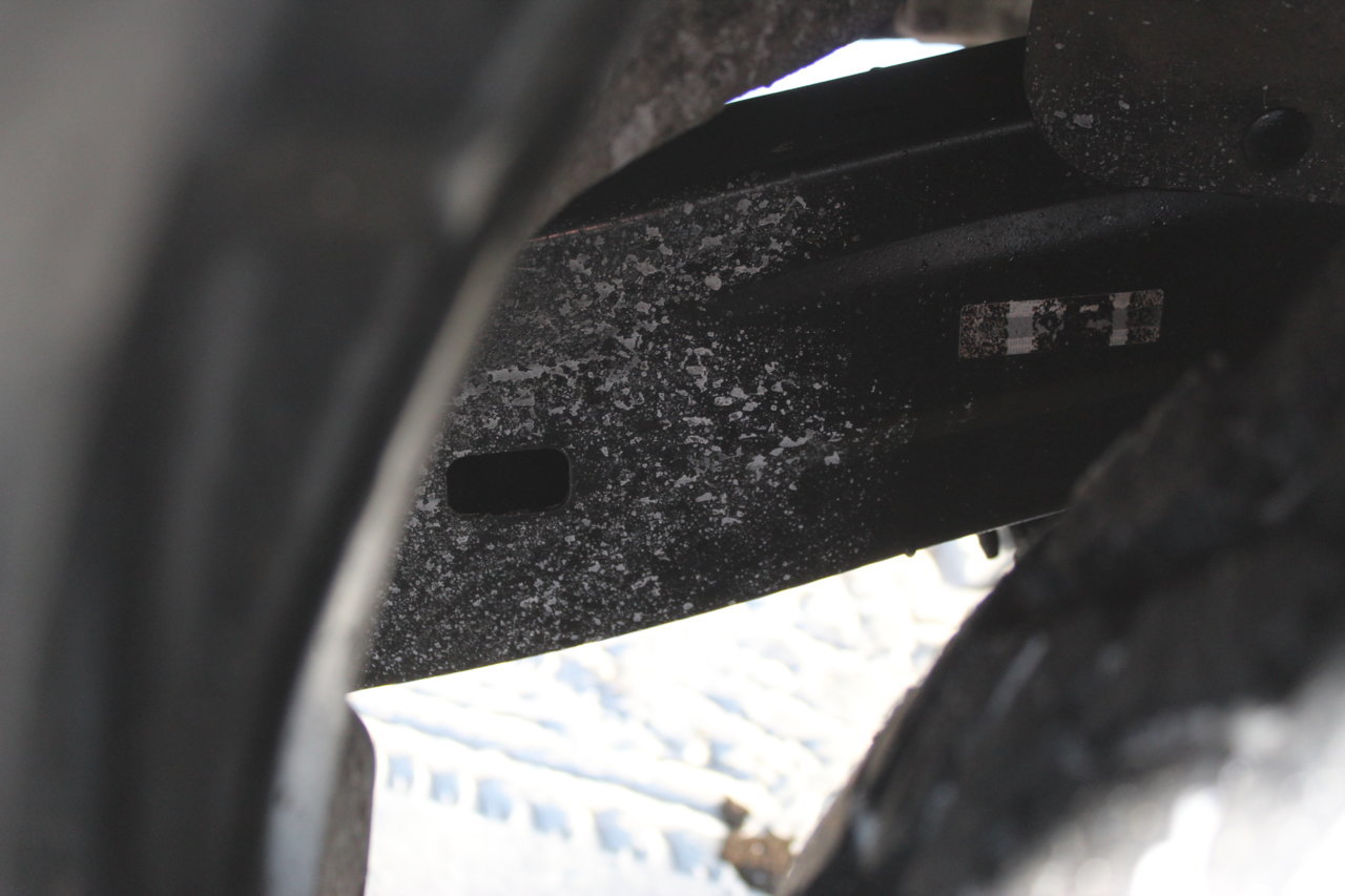

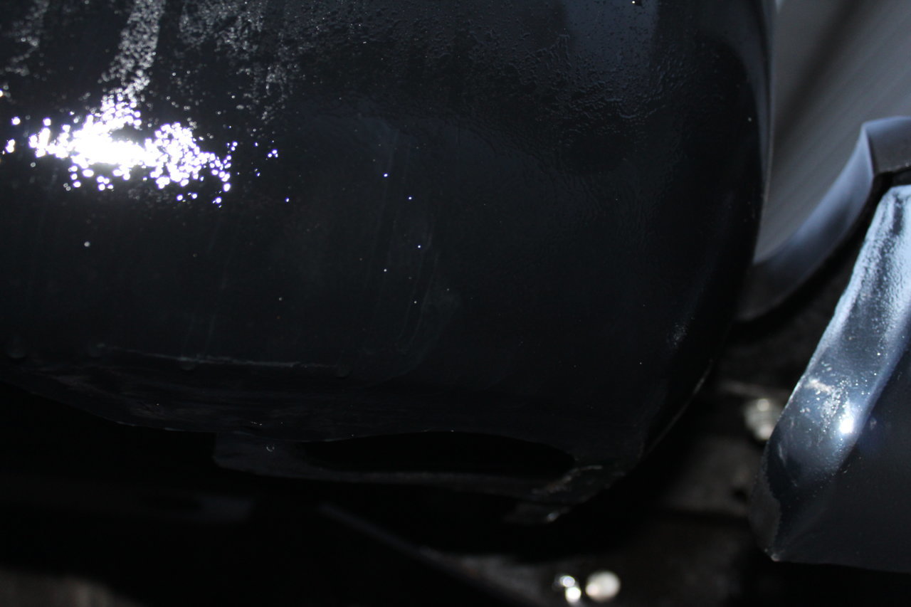

    this other product I am testing out in the mid west, CF 3000 formula, has a chemical makeup to adhere like a magnet which i think is pretty cool!
    it just slithers around upon application, pushing it to where i need it to go into crevices and that. does require an air compressor though that some may not have access to
    a little bit tested out on the frame with the recent road chemical spray on unprotected part just to see the stuff in action
    FF looks similar on the other side of truck, comparing the two products to see what the bitch likes
    but there is definitely a ton more of roadspray on the un FFd area
    maybe the CF 3000 misted better and/or crept down for better coverage,
    still a newbie at all this
