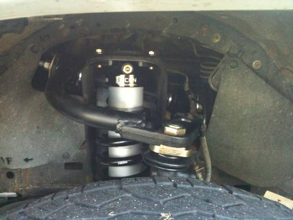

    Is your angle plate in wrong?
    This is how my truck looked before alignment [​IMG]
    And after.

    Yup, that was before the install was complete, alignment is now correct!:D

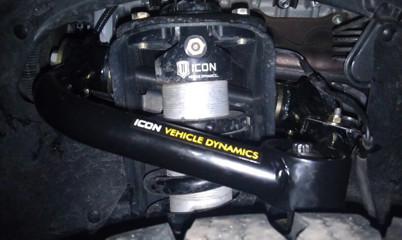

    I'm running 265/75/16 Duratracs on stock OR wheels with ICON external resi shocks and add a leaf in the rear. Basically an ICON stage II kit plus the tubular UCAs. Click on the picture below for more info on what I am running.
