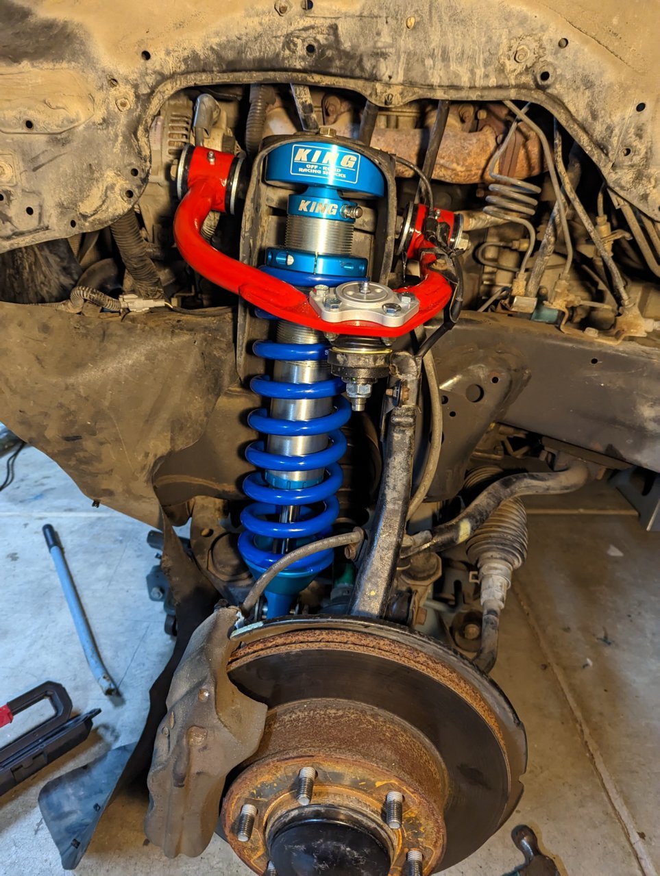

    Both are a waste of money when Total Chaos exists.

    Set up look clean! I was going get the JBA uca arm and the 2.5 oem king shocks. But for what I’m spend on that I could get a 3.5” long travel kit . just have to save little more for the long travel shocks. It’s hard to decide what to buy/build. Found this long travel kit from Jd fabrication. For a good price comparing to other I seen.
