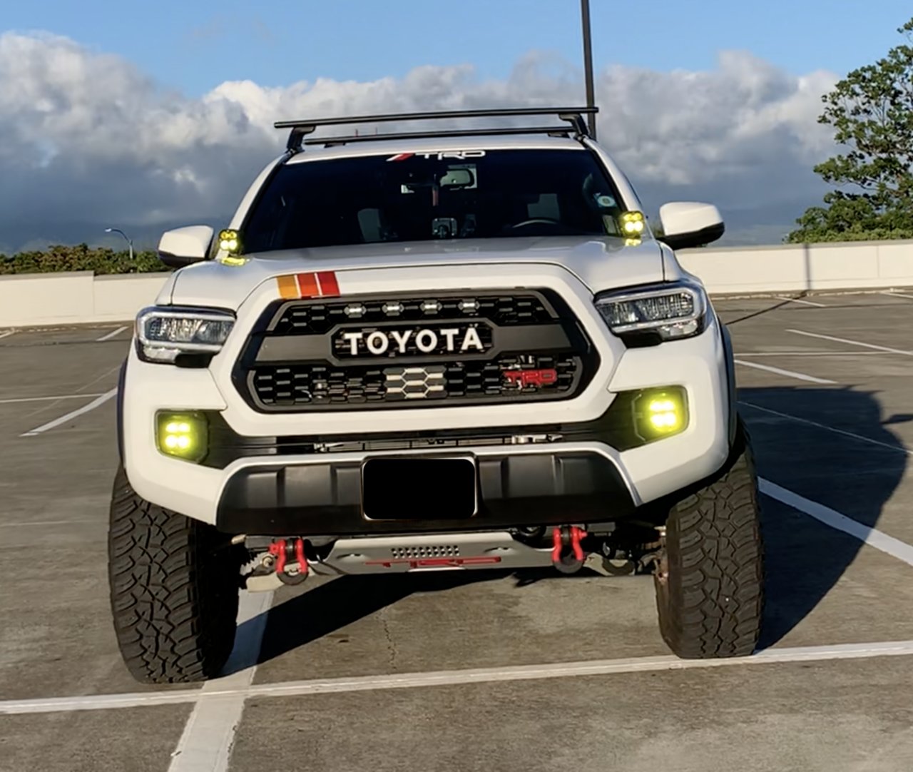

    This truck had 2.8* of caster and drove great at 85 mph. If your truck is a bit "Darty" it might be you have Neutral or Positive TOE??
