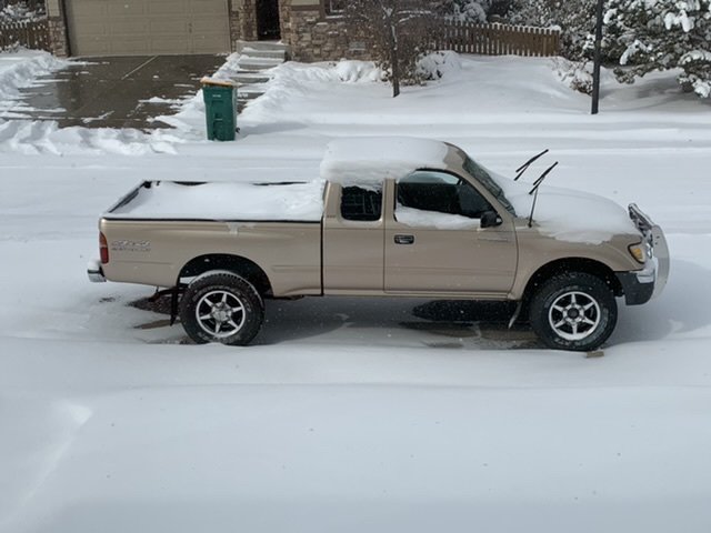

    Hello all,
    I have a 1st 4x4 and recently moved to Colorado from Alabama. Currently it’s snowing like crazy.
    I read that you shouldn’t stay in 4x4 on the road unless you’re just slipping like crazy, but what about 2x4 low or 2x4 high?
    I don't have a locking rear axle or solid axle so usually only one tire spins to move the truck.
    What modes are best for which conditions?
    Also, my truck bed is currently filled almost to the brim with snow (and still snowing). Would this be enough to weigh it down in the back, or should I put my rock & sand filled buckets back there?
    I have towing & recovery straps in case I get stuck, but rather not get stuck.
    Any helpful advice appreciated. I’ve only owned this truck a little over a year and haven’t seen snow with it yet.

    If the roads currently look like they do in your photo there, I would keep it in 4hi at all times. Switch back into 2wd if you are turning into a covered/dry parking garage or gas station, but with that kind of snow cover on the ground you can stay in 4wd and not have any issues.
    4low I wouldn't use unless you find you need it for some reason. Like if you can't get traction in 4hi on a hill. You don't want to be going around town in 4lo though unless you were having to drive through walls of snow.

    The pic was taken right before I submitted the thread.
