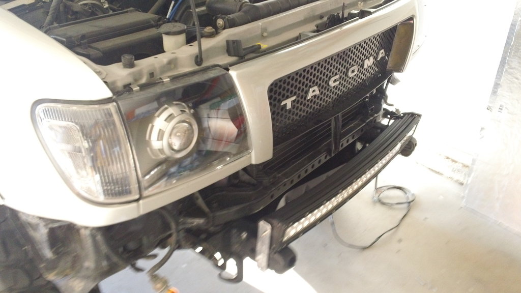

    I would like a LED bar that has a wide flood beam and would like to install in valance but after reading so many post people install mostly 20" it seems and would like to have largest available but not fight to install it... Thought about pods also and wouldnt mind putting them in turn signal areas or on the A pillar..like those eurolife and tuff light and such don't have the money to go get over priced rigids even though they are very nice..

    [​IMG] this is what id like to do.. or something similar...

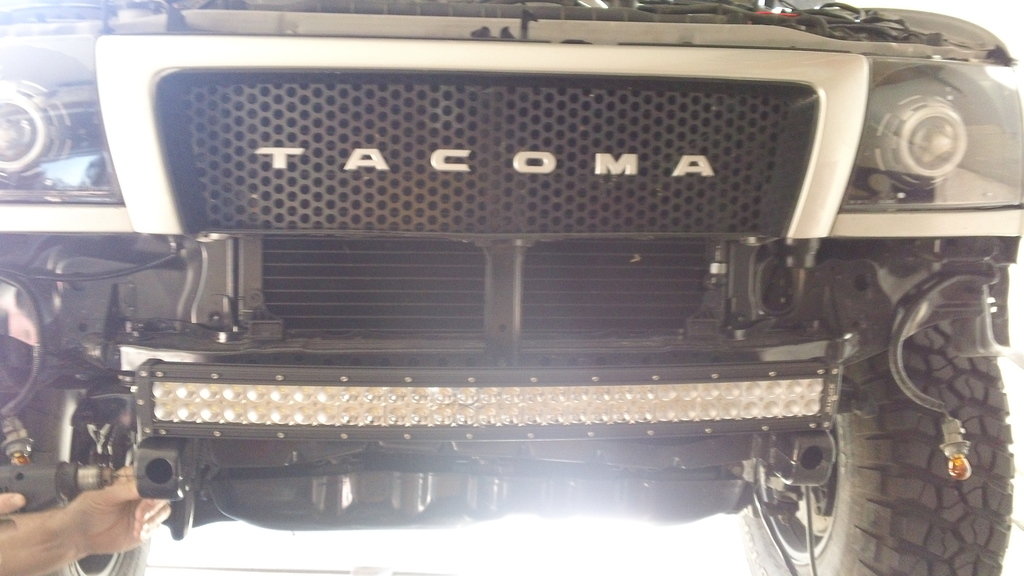

    You might be able to install one on the crash bar beams. Like a 30". Stick your head in there and have a looksee. And anything 3d has a nice spread of light. If you can find a 30" 3d, most are 50". And the ones I see that are 30" 3d are overpriced, more than the 50's... Certainly not 4d or 5d if you're wanting flood though..

    But, not sure what you got goin on with those sizes.. Where's the 32" gonna go? Valence? Not sure a curved would be practical in there. Unless it's for the roof. Then it's a tad short. 42" is probly minimum for roof. And the 21" isn't gonna be a lot of light. Its fine for how much it costs, and is a good design. But if you plan to get a roof bar, the roof bar will overpower that 21" no prob rendering it useless. If you are gonna go for a 21", I'd get either a double row, or single row 10watt style, 'IF' you plan to add a roof bar down the road.. But yeah, that 32" is an awesome 3d bar. Again not sure where you're planning on putting that one.. But I think you can get away with a 30" straight bar to take up the whole valence slot. That's if you can mount it on the crash bars like most others do with 01-15's. Your bumper is a bit different so it may not work as easily. But I'm sure it can be done with a longer bar with some creativity.
    I WAS debating on swapping my 20 out for like a full size 30 in the valence. But I have other uses for the extra space on sides with my 20. So I ended up ordering an upgraded version of my single row 20" in 4d, 17k lumens, with 15 watt leds. This one:

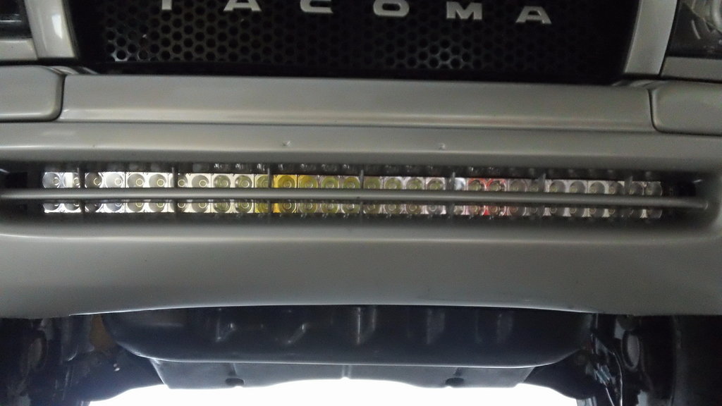

    Ok so yeah, that single row in 31" would be pretty good. 14k lumens. 5 watt leds. Nice price too. Again I think you could get away with a double row in the valence. But its cost more so Depends on your budget. I like the look of that picture of someone else's bar in there you posted.
    And what about the curved one again? Were you thinking of mounting that straight on the bumper, not in the valence?

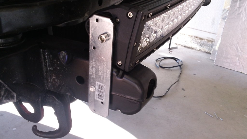

    And yeah I agree. Mounts are pricey. I was lucky enough to fab my own. Barely. With some help. Glare is bad with lighter colored vehicles, especially white from what I hear. I've got black, and a 5% tint strip on windshield so that helps. Thinking of doing a blackout strip instead. But it really doesn't bother me too bad unless it's dirty. Just gotta make sure my windshield stays clean clean clean. Ha. Even the slightest dust is horrible. But a quick dry wiper swipe or two sometimes will clear it enough. Bugs are starting to come out so I'll be cleaning it every damned night soon.

    yeah was just thinking of mounting directly on the bumper for the curved one. easy to mount and drill holes and i can tack weld it so it cant be stolen also... lol i wonder what a curved large light bar looks like on the bumper lol and still looking for decent ditch lights that are floods.....

    i have 1 7/8 inches in height and 31 inches wide i can go and like 5 1/4 inches to the place to mount the led bar so i will more then likely have to make my own mount i guessing...

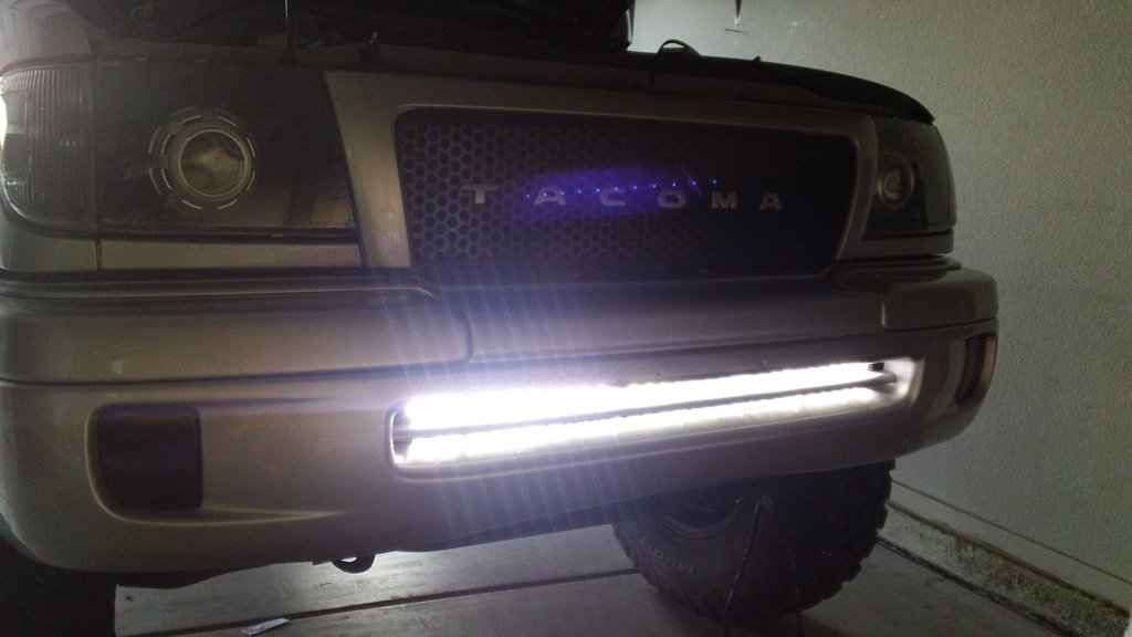

    Mine is 32" curved

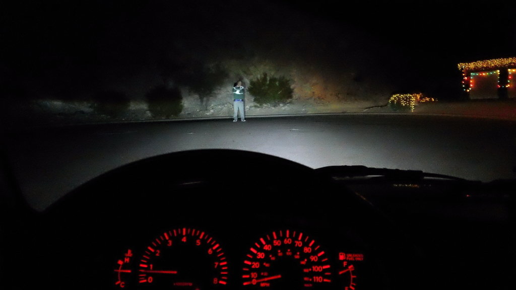

    Not sure what you mean by height, the bar is ~3" tall. Here's the lo beam:
    Light bar only:
    Hi beam and light bar:
