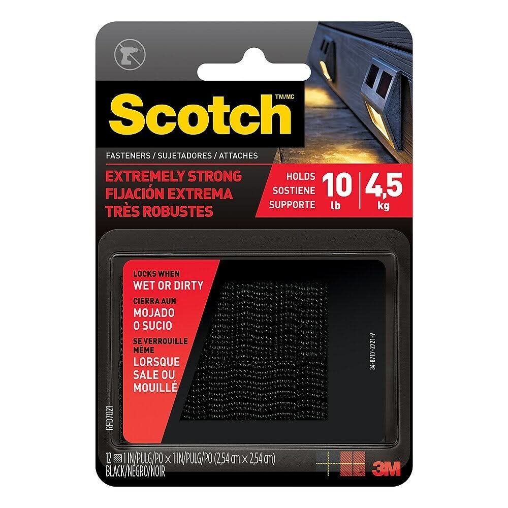

    I’m currently using this on my pillar to hold my snorkel and no issues so far.
