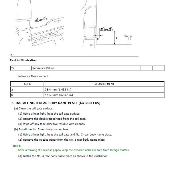

    When I install stickers, or my red toyota 3d badges, I use painter's tape to create a straight line at the desired height/level. Then just place the decal on the straight tape line.

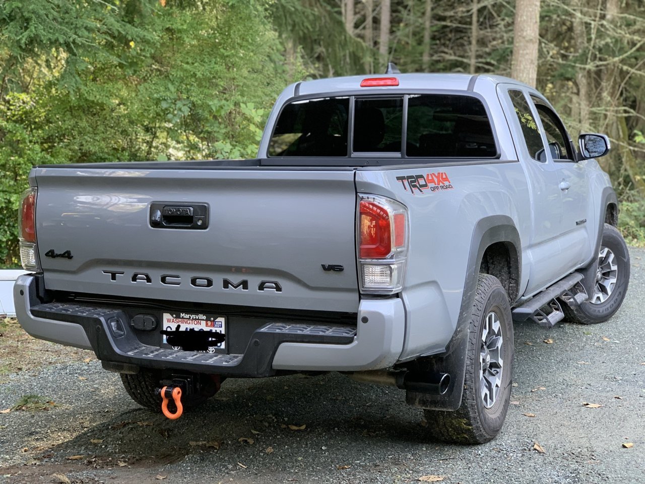

    the info in this thread was really helpful, thank you!! I’m still feeling out whether I like all the badging — I was thinking of replacing the bedside decal with A custom one that just says TRD Off-Road now that the 4x4 is advertised on the tailgate. But for now I’ll just wait and see if this grows on me or not!

    This was excellent! Can you dig up a install doc for placing the "TRD Pro" emblems on the passenger side of the tail gate?
