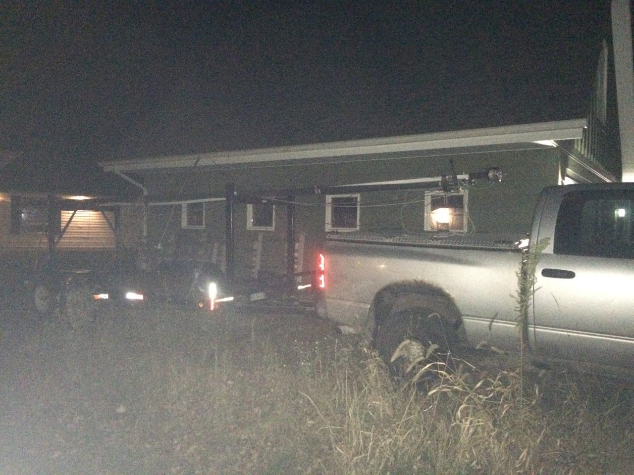

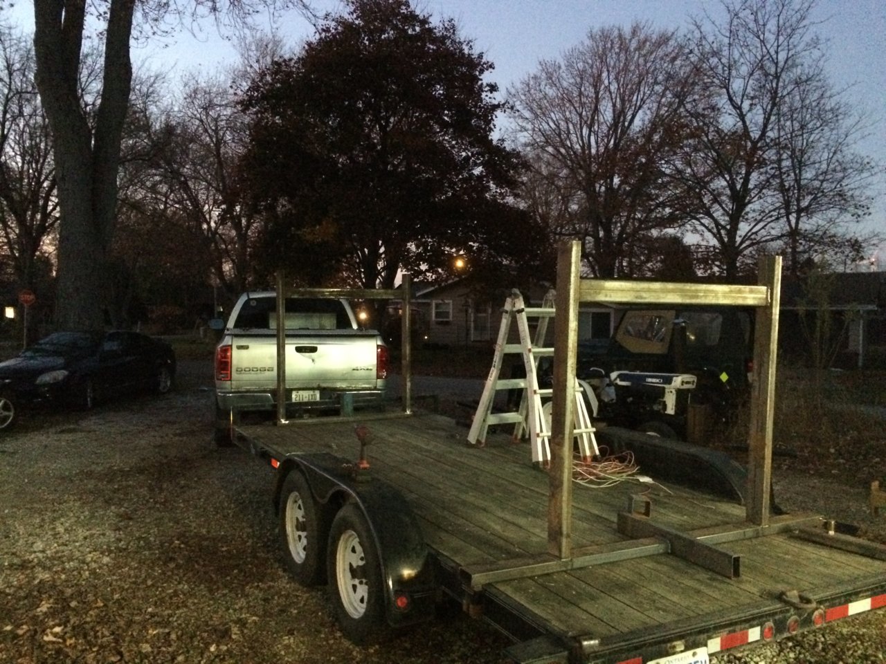

    I used this rack I built on my 16’ trailer to haul a 29’ sailboat mast.
    I work at a steel tube mill and buy “scrap” tubing all the time. Without the rack my maximum is about 20’ legally. With the rack I can easily do 30’ by going up and over the bed of the truck. I have yet to do any long loads since I sold the Dodge and got the Tacoma but the lengths possible is about the same. Now if you look to industrial suppliers that deliver small pipe and tubing they have essentially a standard bed rack with a (third) front support coming straight up from the front bumper.
    I prefer the trailer option but if that doesn’t work for you then the front support along with the standard bed racks is my suggestion.

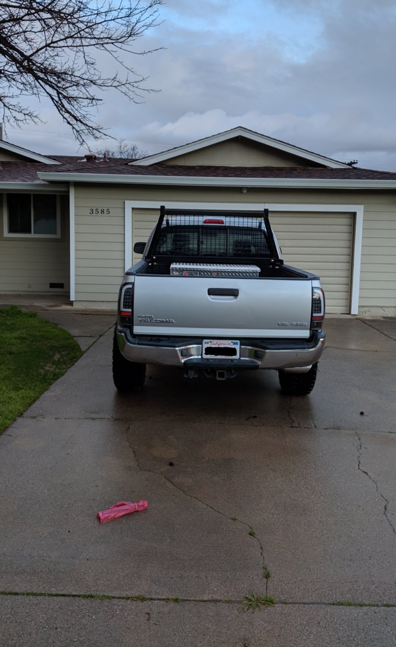

    Here's my backrack on my 2nd gen, they make multiple styles, but they all use a mounting bracket that goes in the bed rails. I installed mine in about 20 minutes. Total cost from Car ID to my door was almost exactly $300. It would look pretty similar if not maybe better on your 3rd gen I think. It's all subjective though, so you may not like it still.1041709765.jpg
