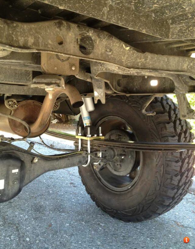

    I guess for at least the first step of removing the ugly tip, something like this (pic from a Tundra) might work, keeping the exhaust heat wrap still on
    leaves plenty of meat left for future cutting, yes is hot by the tire but not as much with exhaust wrap, and still escapes exhaust gas out underneath

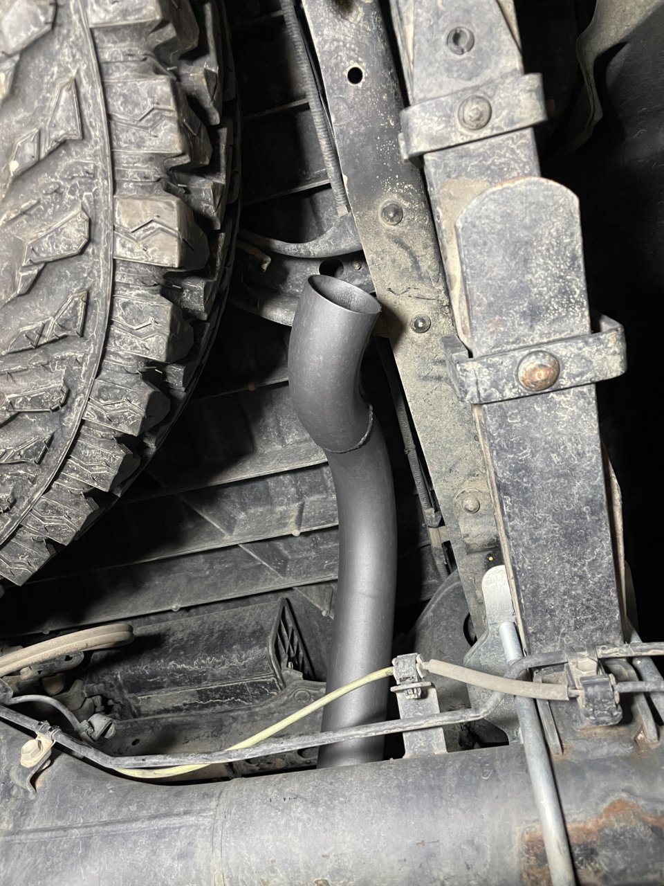

    I have option 2 and not once thought about whether exhaust gasses were building up under the bed of the truck.

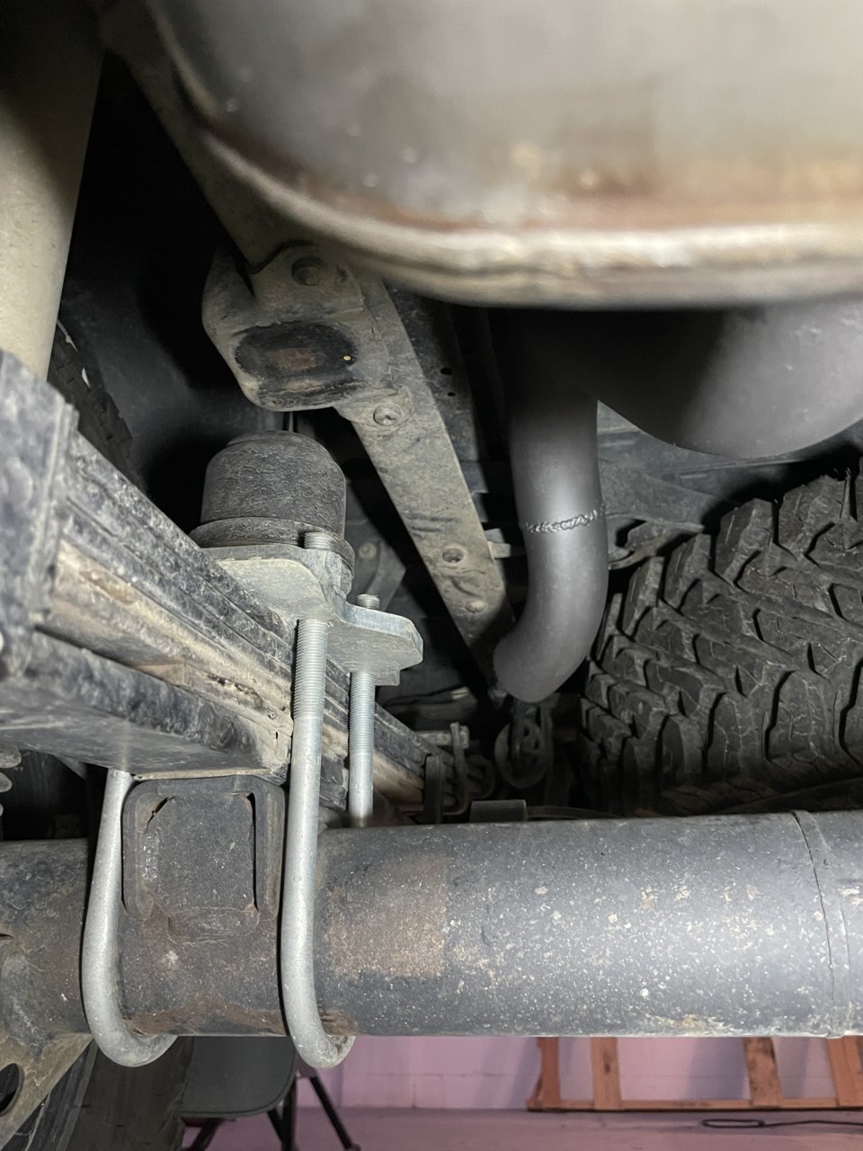

    I'd definitely skip the special exhaust cutter purchase unless you think you'll need it a lot down the road. Hacksaw, reciprocating saw or a die grinder with a cut off wheel all work great.
    I recently just did option #2 on my truck but I was also adding the TRD Pro muffler to my stock exhaust system so I had the opportunity to do a little more customizing.
    My 3rd gen exhaust was stainless steel, not sure about the 2nd gen TRD Pro's. I'm also surprised that you wanted to add a resonator to yours. I just swapped out my stock muffler for the TRD Pro muffler and so far I can't tell a difference in sound at all.
    ***EDIT 3/20/23***
    I've since learned that my setup is not so great. I didn't realize how much heat was directed at the leaf spring and it easily melted the plastic pads between leafs. This is just a 3 leaf AAL which I'll be replacing with a full leaf pack so I'm not worried about it but I will be changing it before installing the new leafs.

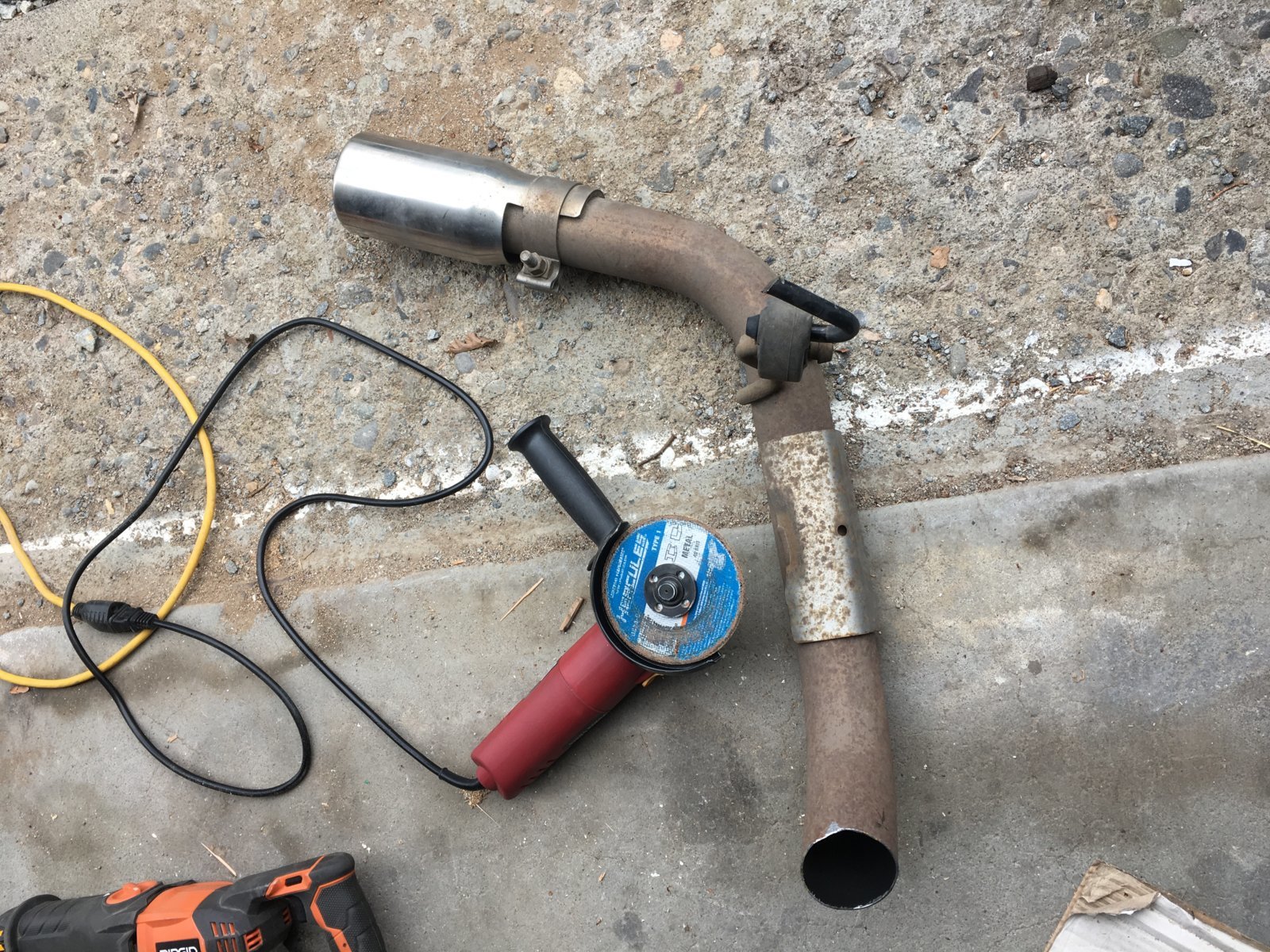

    chain cutter... does no one own a saw-z-all and metal blades? grabbed my M18 Milwaukee thew a blade in it and chopped away. then grabbed an angle grinder and just worked around the mouth of the exhaust tip jsut because I'm sure I'll be under that all again and don't want to get cut just in case.

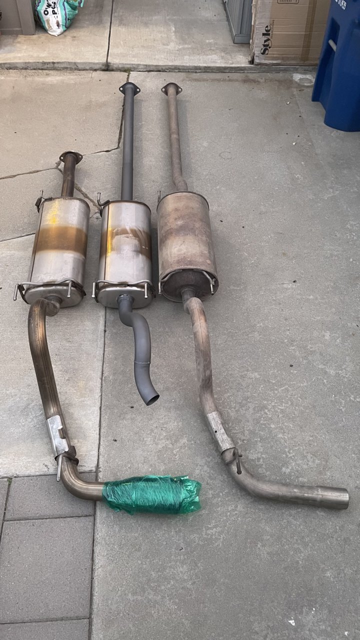

    Where in socal are you? I have a stock exhaust that I already chopped off my dcsb you can have. I only cut it off because I smashed the tip. Maybe you can use it for parts at least if you want to sell your complete trd exhaust.

    If you’re still dead set on cutting it, a sawzall will do the trick.

    I know this is an oldish thread but, for those who have chopped their tail pipe as seen in pic #2. Does your spare tire get to hot down there with the exhaust hitting it while driving?

    Hasn't been an issue for me. I have a 265/75/16 under the truck and my exhaust has been cut at the axle since 2018. A 255/85 or 285/75 might be an issue but you could easily redirect the exhaust by running a tip to direct the exhaust away from the tire more.
