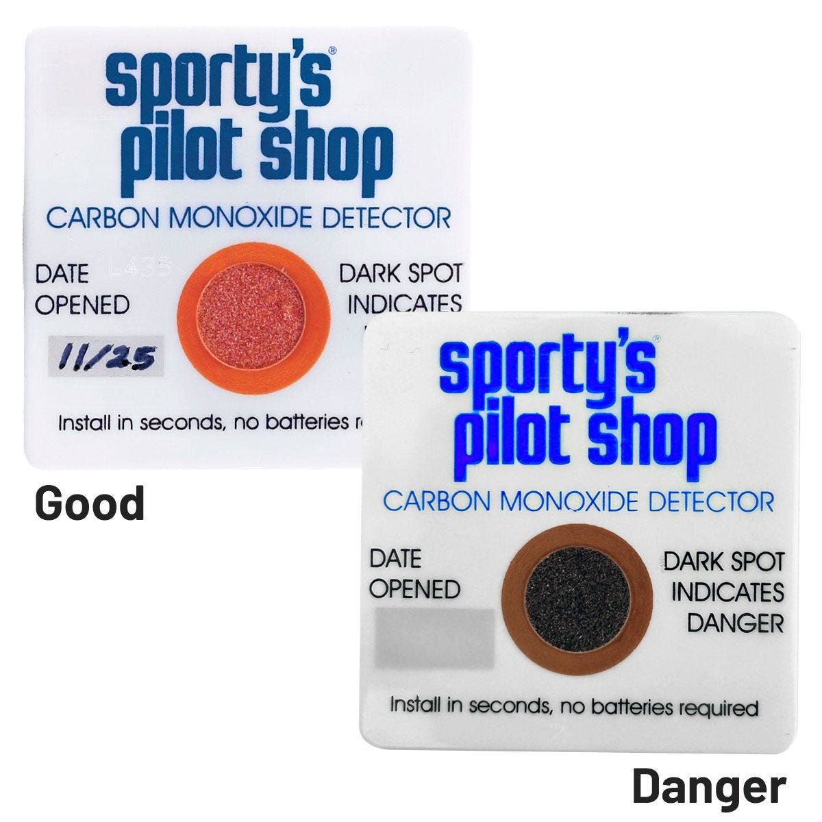

    It is not a big deal. For your own peace of mind, buy a CO detector card from a pilot shop and stick in your cab. (Small aircraft heat the cab from shrouds around the exhaust manifold & pipe because the engines are air-cooled (no water jackets). If either pipe or mani crack ever so slightly, pure exhaust is ducted into the aircraft cockpit and CO poisoning becomes a serious threat. Made worse at altitude.)

    what kind of carbon monoxide detector did you use?

    $5 from Sporty's Pilot Shop.
