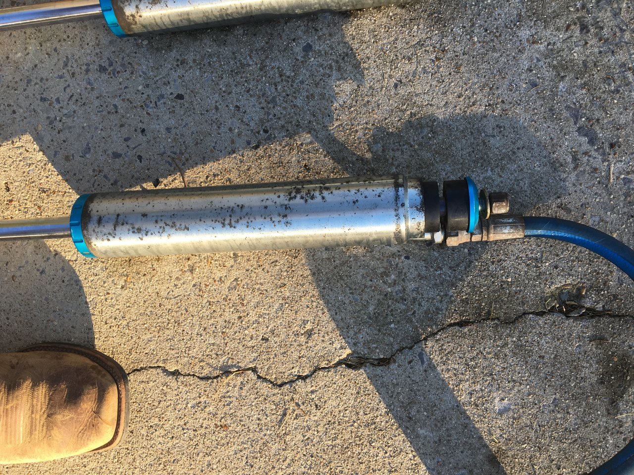

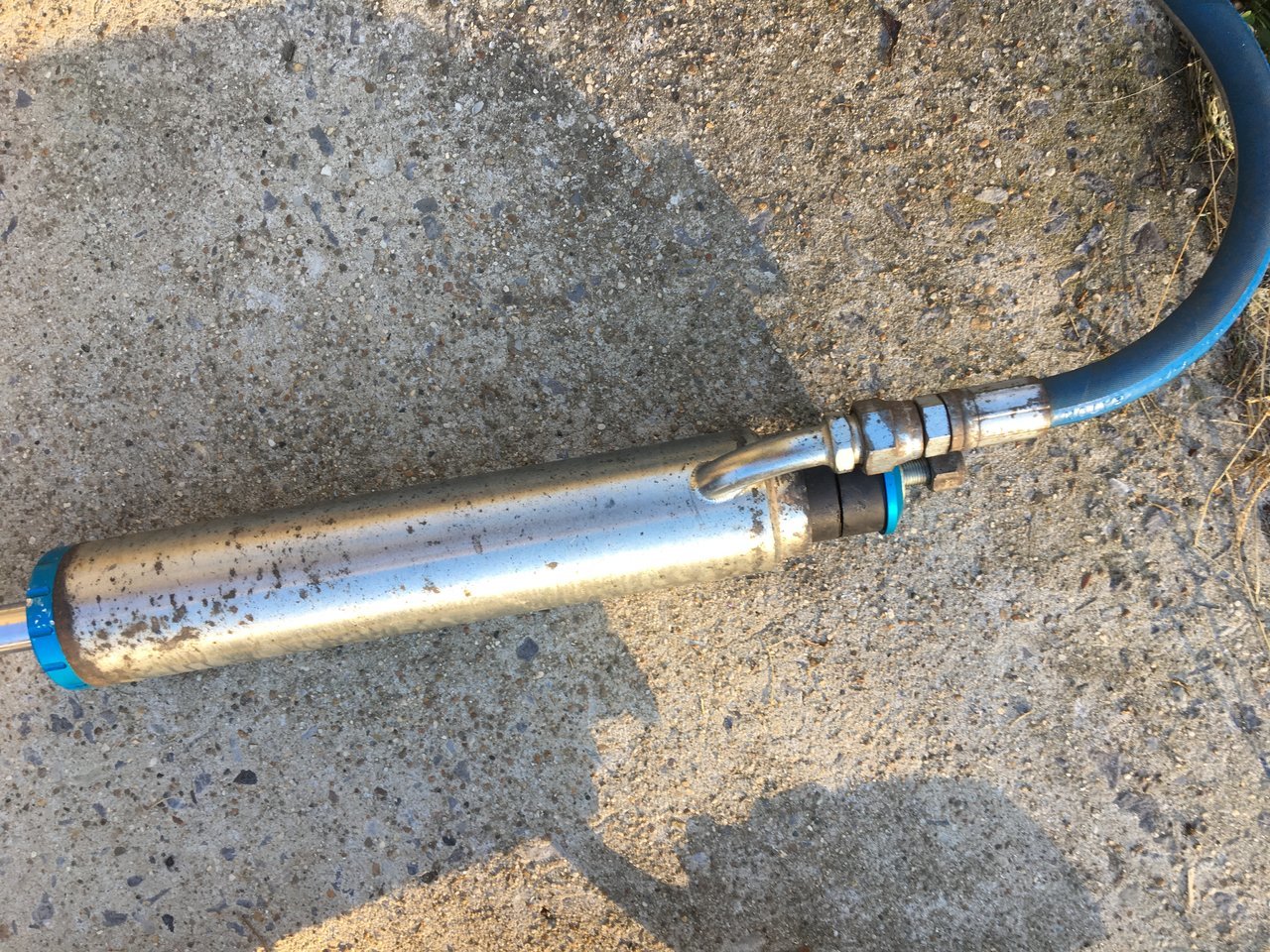

    What's the best way to remove the oxidation and surface rust on these shocks. I tried the 0000 steel wool and wd40 method with little success?IMG_5900.jpg IMG_5902.jpg IMG_5899.jpg

    Those are pretty rusty. Maybe break them down 100% tape up parts you don’t want to be touched and take them to be bead blasted. Then spray some high quality clear on them and keep them coated with some fluid film.

    Just use a wire wheel on a grinder to get the oxidization off ( it's aluminum so it's not rust ) then use some grey scotch bright to give it that brushed look and last but not least clear coat.

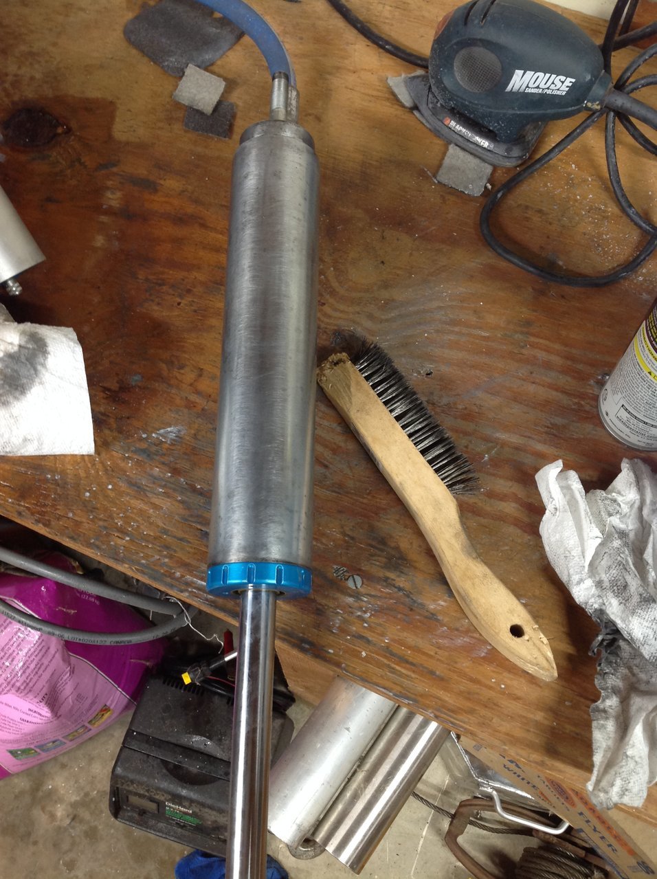

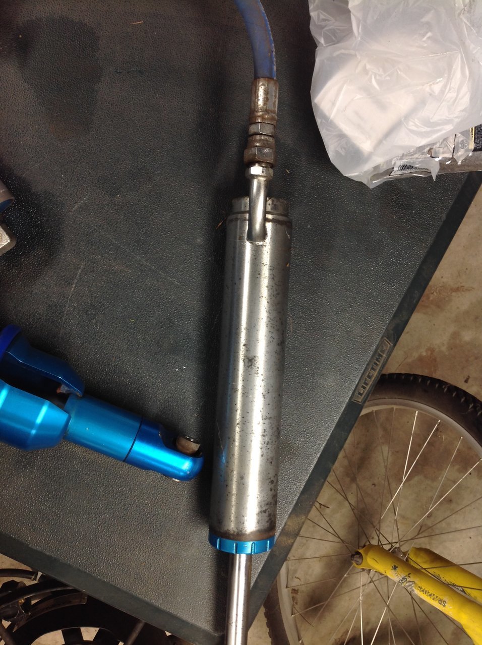

    In the garage now, decided to try different grit sand paper. Im using a fine steel brush on the fittings, and having a lot better success. Really didn't want to sand on them but oh well it's working.
    Before:
    After:

    Looks good. Just step down a few times to get a smooth finish. Also thinner wipe and clear with something....I was reading the other night that a lot of guys use S.C. Johnson paste wax to coat table saws so they won’t rust. Maybe a product like that could work. But if probably wouldn’t last long in the elements. I’d Look into unsung a urethane as well.

    Looks like you got it figured out. Get a quality coating on it before they rust again, Steel-it is a good choise and close to the Zinc color.
    FYI those are steel bodies with a Zinc coating. New bodies are about $80 each from King and getting them stripped and replated is about the same. They will need to be completely broken down and rebuild to do either.
