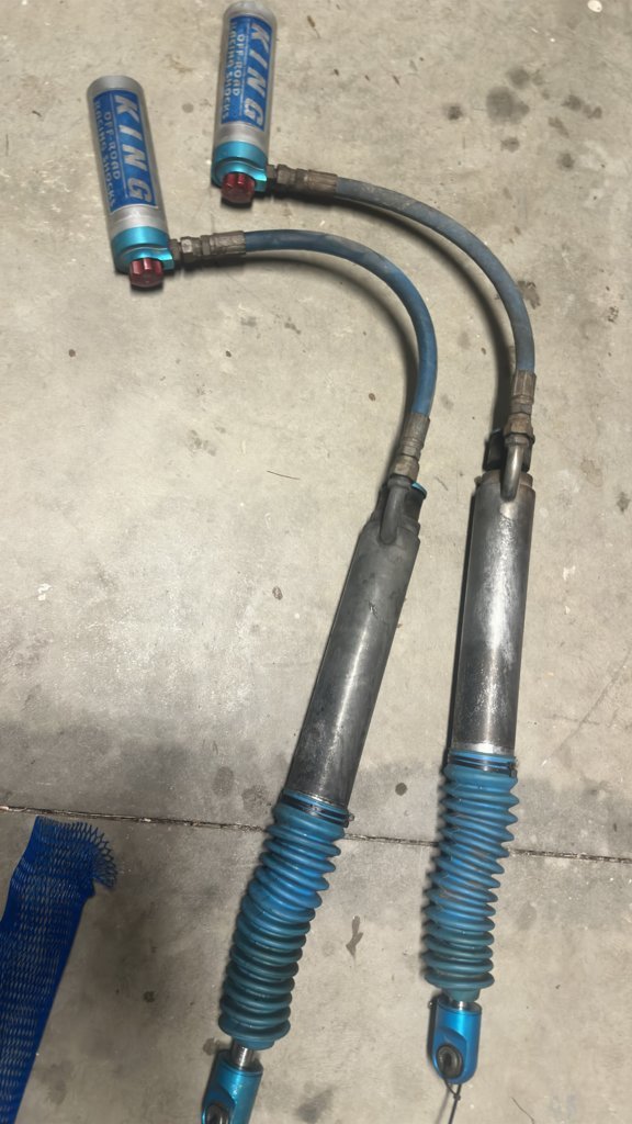

    I got the fronts pretty well cleaned up. Will get some pics tomorrow and post them. Pretty happy with the out come, I just hope they don't need rebuilding once I put them on.

    You did well cleaning them up, but whoever sold them to you was definitely not honest about "6 months old" or "only 5k miles"... But you're obviously making the best of it and buying used suspension is always a gamble because there really is no way to validate the history or usage, outside of tearing the shock bodies apart.
    I would absolutely find a paint or permanent protective finish to coat them with as all of the aggressive blasting/sanding/cleaning, etc has broken down the original coating and exposed the bare metal material.
    After painting, I would keep them sprayed with FLuid Film or something of the like to keep em lubed.

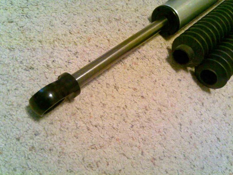

    Yeah, if I lived in the northeast US or a coastal town (salty air/water) I would definitely get shock boots. Here is another idea for the rear:
    59452d1342037069-shock-boots-coilover-co_e53319a9ed552175ea3493dae86a8bcea2f28e24.jpg
    last one is not a tacoma, and even worse, the orientation is flipped on tacomas so the piston shaft is more exposed from filth and debris flung up by the tires, so I've read that you keep the bottom of the boose loose to allow particles to fall out,the boot will serve to keep a bunch of crud out and protect the piston shaft, but not trap in anything long term

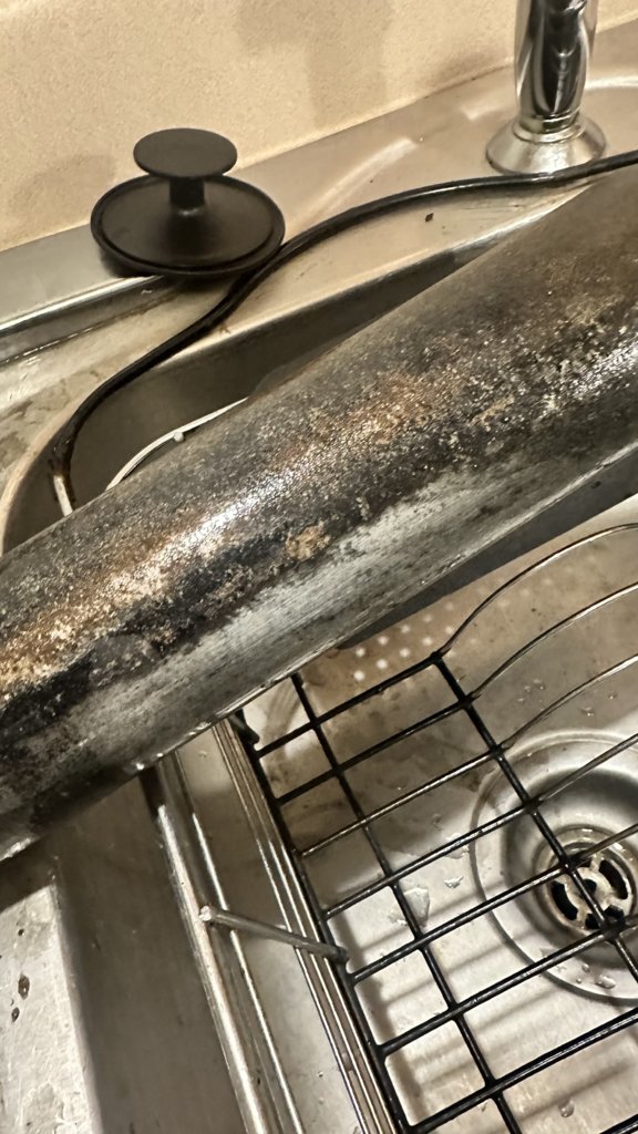

    Any recommendations to clean this up?

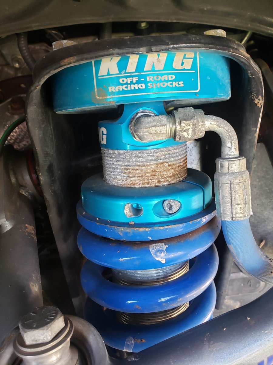

    Not optimistic but I’ll try some brushes and naval jelly on this. Anyone have any pointers on what they did?
