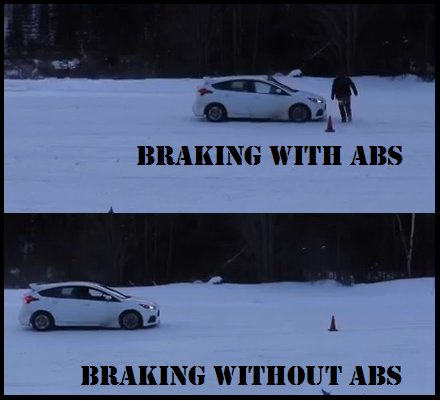

    For anyone that was too lazy to watch the video or maybe it was blocked because you're at work....

    The video is real nice but a couple weeks ago I thought I was going into someones house;it was a steep hill on a turn icy/snowy roads couldn't stop or turn,luckily no one was coming the opposite direction..That's my first and last,scared the bejesus out of me,I'm going to disconnect both the 04 an 08 very,very soon..

    Abs makes you stop further in every terrain

    Every terrain? Not true. Only surfaces that can build up under the tire like deep gravel, sand and loose snow would make a car stop slightly sooner without ABS by locking the wheels, effectively creating a wedge between the tires and the surface. This is of course only true in a straight line comparison as you lose any steering ability when the wheels are locked.
