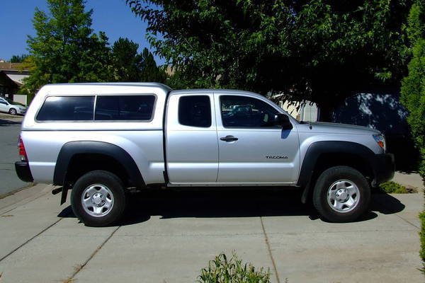

    4Wheelin4Banger
    4Wheelin4Banger Longtime Toyman
    Jun 15, 2011
    #58306
    6,810
    Randy
    Ferntucky, NV Halfway between Reno & Falabama
    2011 4x4 Access Cab Silver State Edition
    3" OME lift 885s & Dakars riding on 33" KM2s Click the sig pic to see the build thread .
    Dakars HD 7 leaf pack 5 Main & 2 OL with 5100s ride great.
    I got 3" rear lift from stock to match my 3" front lift with OME 885x and OME 90000 Nitro Sport.
