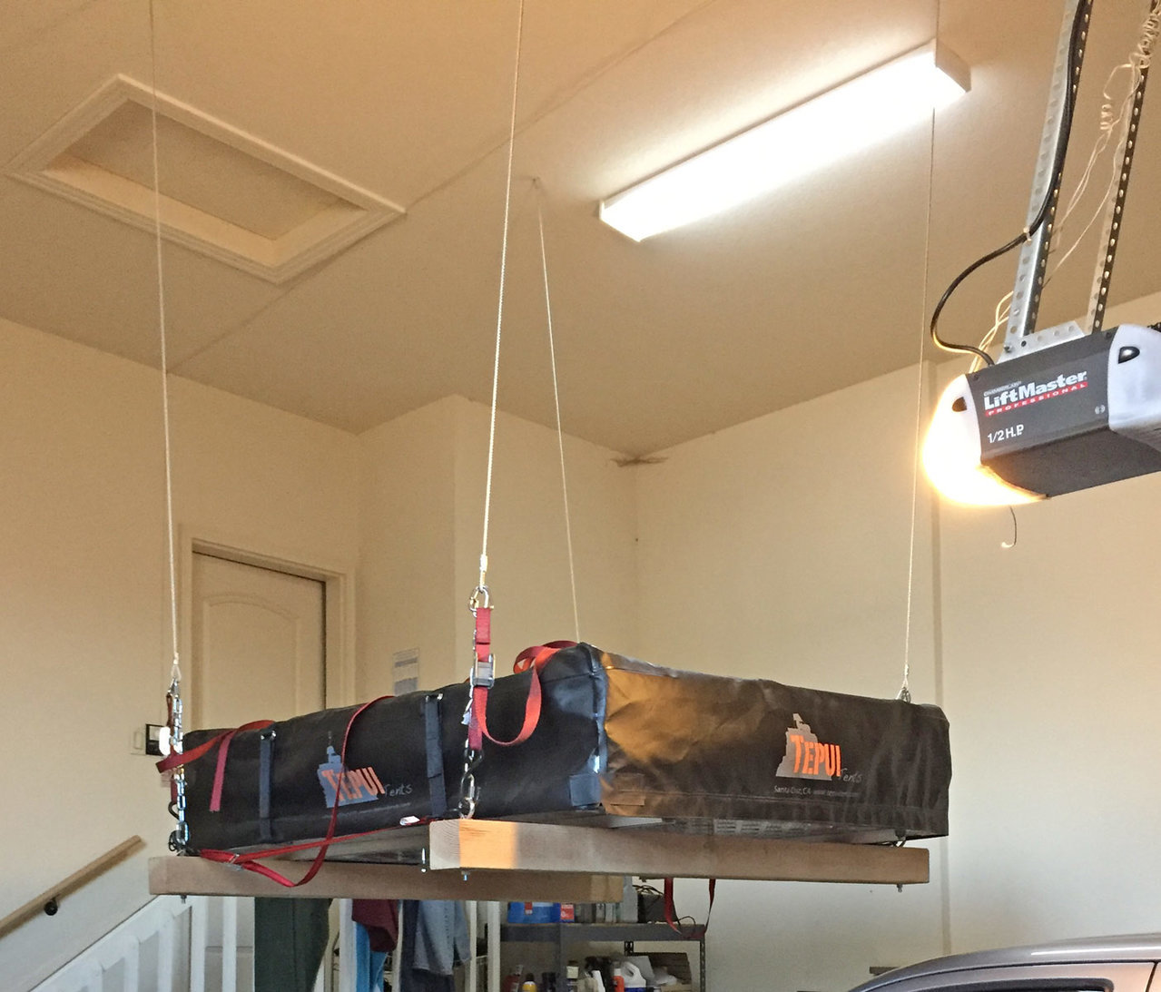

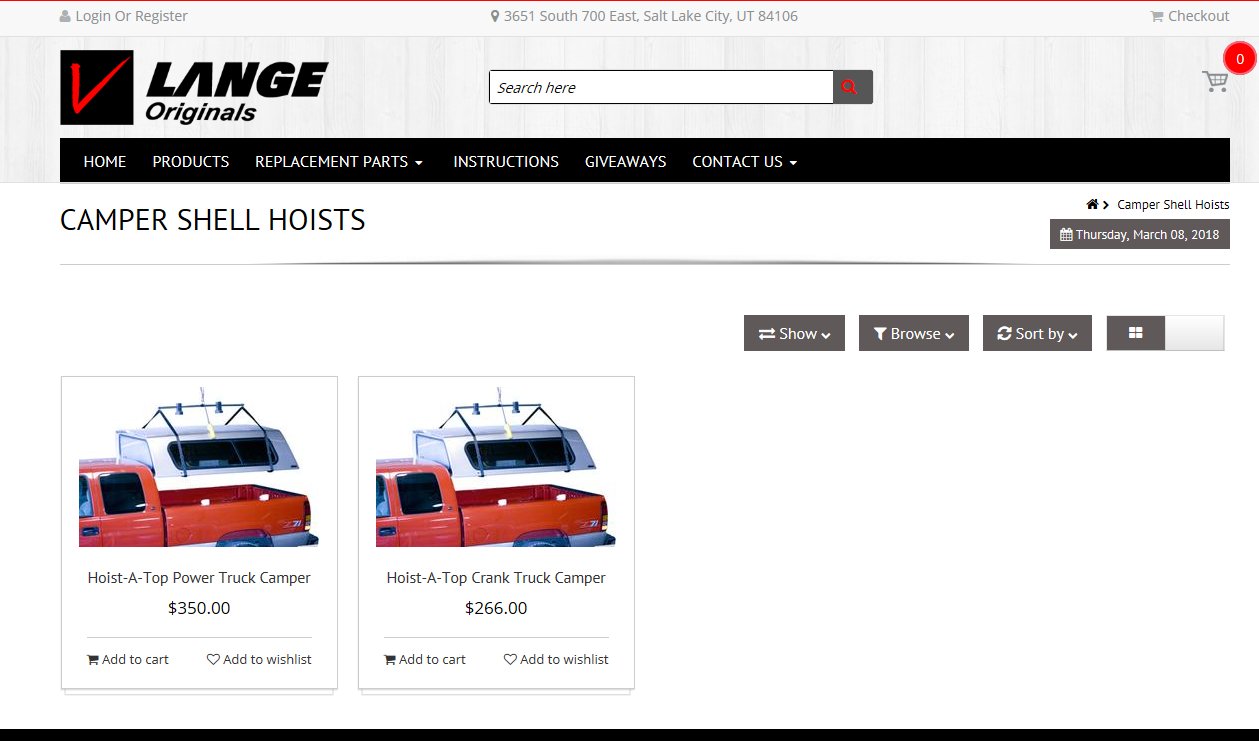

  5. Mar 8, 2018 at 8:56 PM
    PJL
    PJL [OP] Well-Known Member
    Mar 25, 2017
    #214348
    155
    Baltimore, MD
    2003 xcab Tacoma 4x4
    Stock
    This is what I'm looking for. I actually found one made for lifting caps and jeep tops from this link. I may just use the design and rig up my own from pulleys and tackles. This gives me the basic layout. Thanks. When I get it figured up I'll post pix and setup.

    I use a a couple of 4x4's suspended with eye bolts, and motorcycle tie-downs to raise/lower/store my 180 pound RTT. Not as quick as a pulley system, but cheap and effective. I raise it up 2 inches, one corner at a time. Takes me about ten minutes to lift it up 2 ft.

    @15+1 has it right. With four straps (good for redundancy) you’re basically only lifting 1/4 the weight, so reefing on the straps a little at a time is easy.

    I like it a lot.
