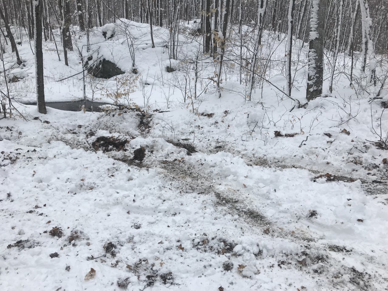

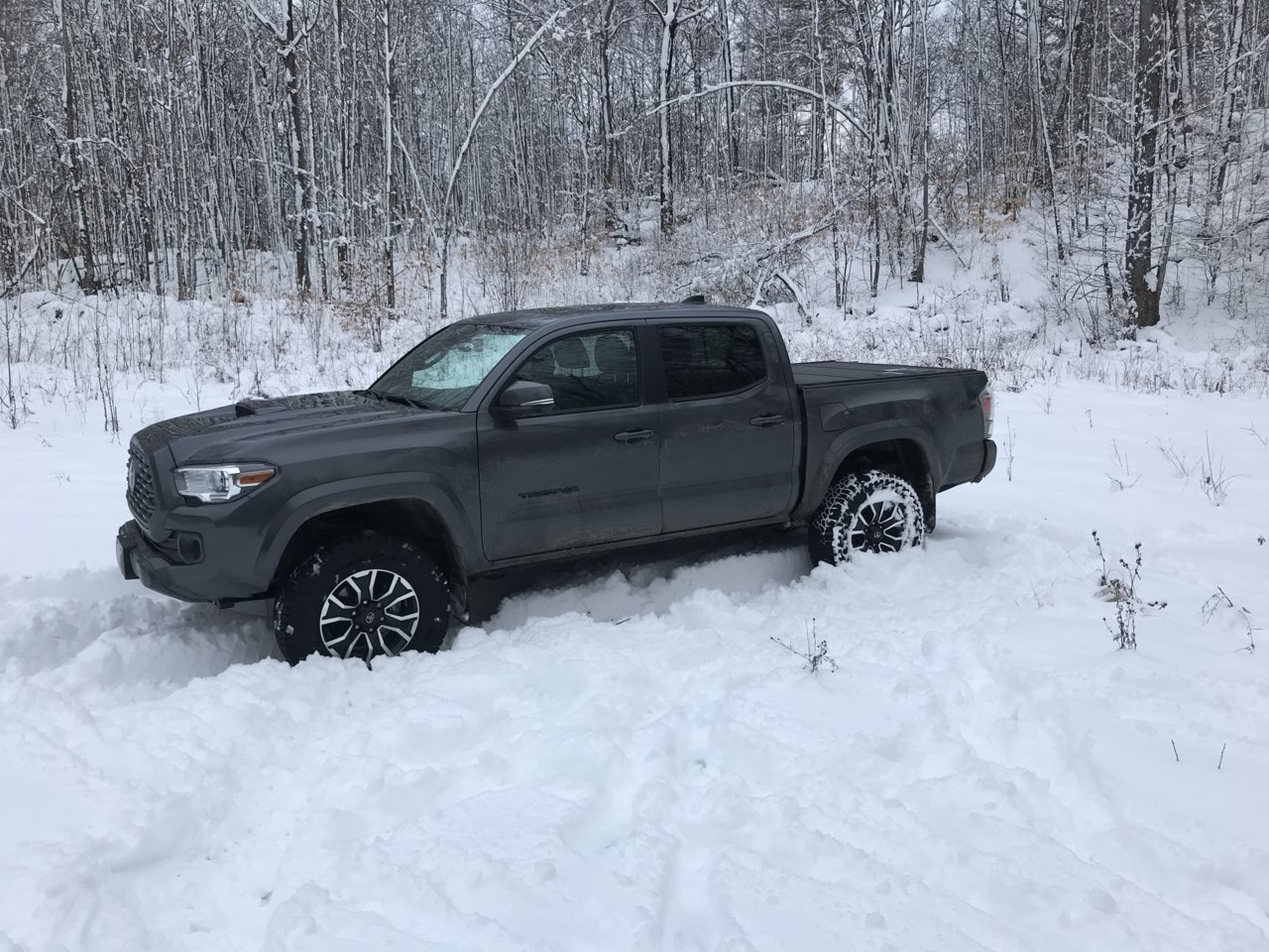

    1. A good snow shovel.
    2. drop your tire pressure.
    I’ve gotten stuck multiple times this winter on some deep stuff (12-16”). I have basically the same setup as you with regard to tires and lift height.
    Each time I was stuck I dropped the tire pressure to 18 or so psi (realistically should have done this first, maybe lower) and then dug out the snow until the frame wasn’t hung up, and tires could see ground.
    next year I will have a proper deflator and a means to air up, the same shovel (it’s a full size with a square aluminum head so that I can move earth if needed), and traction boards.
    down the road when the wallet will allow I will go to a larger tire (255/80 is what I’m looking at).
    now I’m no expert but that’s what worked for me this year.
    another hot tip is to walk the area before your drive. Snow can be misleading in terms of depth. Last picture is where I parked after getting unstuck in the location in the first photo lol. That was a hill that I slid sideways down and into a ditch. Fun day.

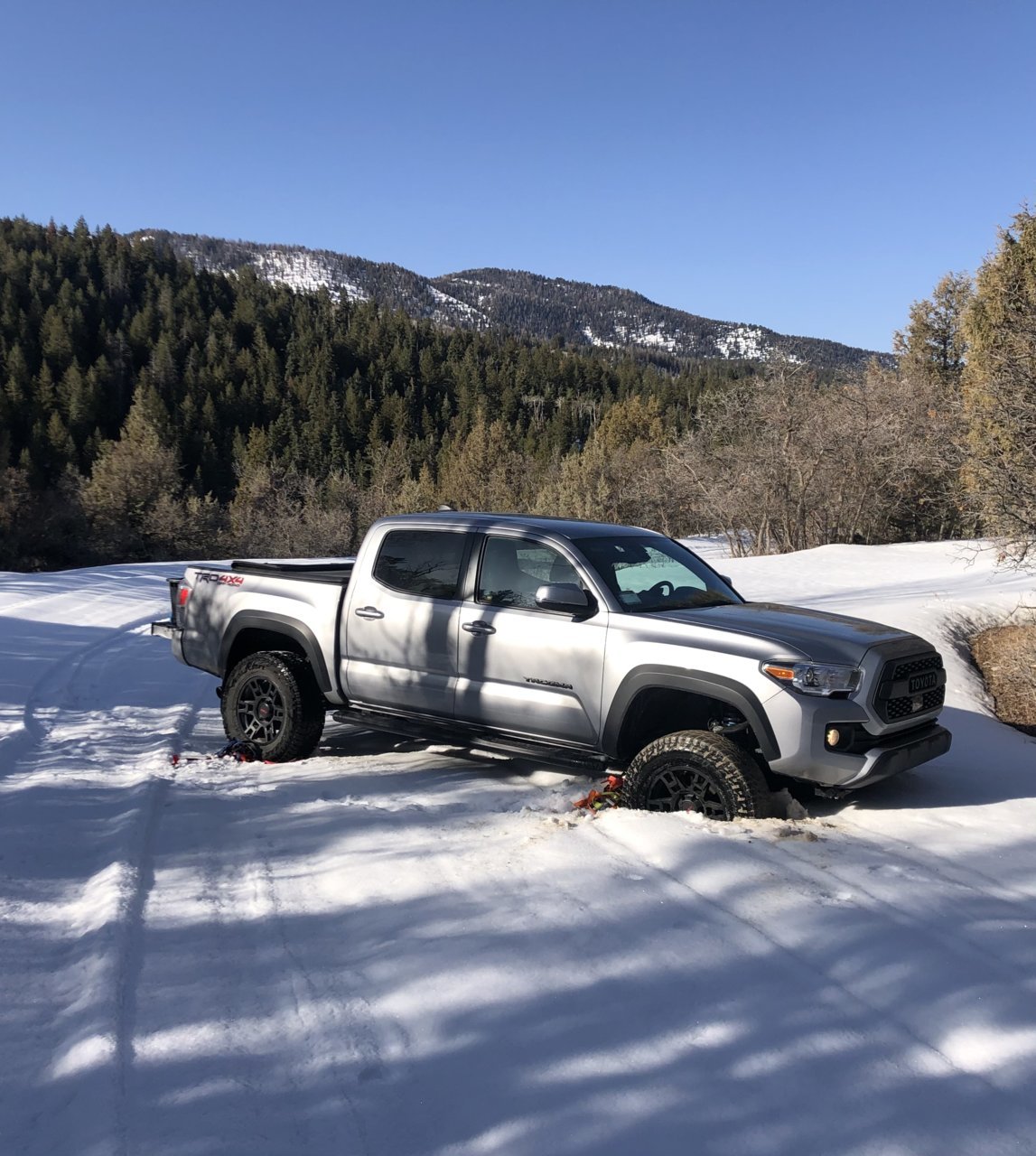

    Ya. Read that on these forums when I did a quick search after the fact. I kind of chuckled inside since that is exactly how I got out!!
    Here is a pic. notice how as soon as I am off the trail, front wheels sunk! (Yes, I’m new at this, but did have enough logic to know what airing down does)

    You described a condition called high centering. When that happens... shovel.
