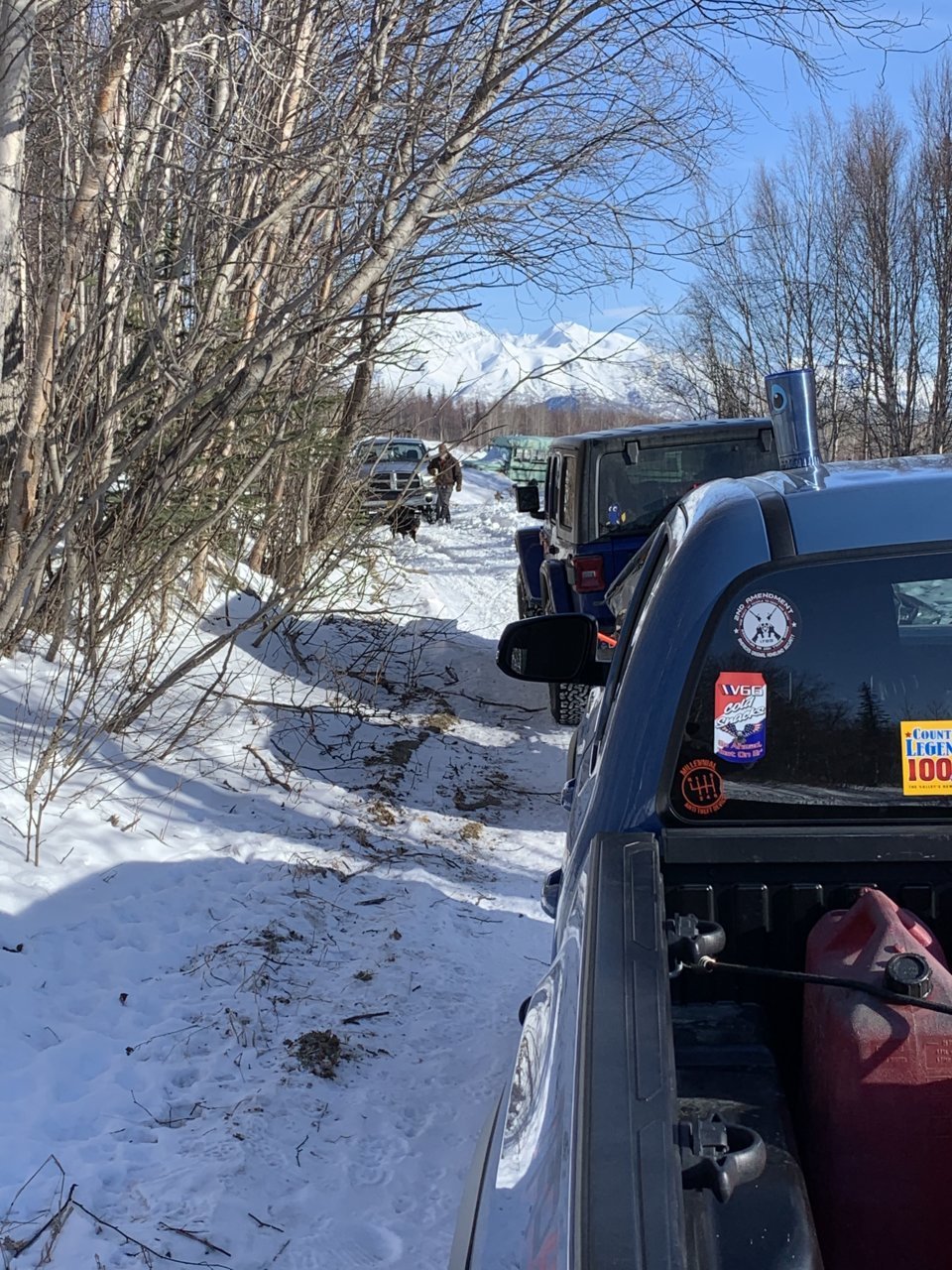

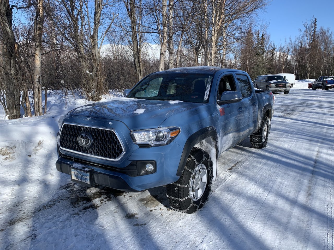

    I air down to 15 psi.
    4Lo 2nd & 3rd gear, engine and drivetrain most responsive 3K rpm and up (manual trans)
    locker not effective once stuck
    ATRAC more beneficial than locked rear. When rear locked ATRAC cuts out above 3mph.
    chains in heavy snow or ice
    *not sure how any of this translates to drive for me automatic computerized crawl control shtuff :notsure:
    2F3179F2-2F47-4B79-837B-B4E90FA6B1E1.jpg FE83B417-8AF5-41BE-A203-F6F8A58A6064.jpg E331EA27-CE21-466F-9BAA-4C2E2E50A722.jpg
    Do it every break from work.
