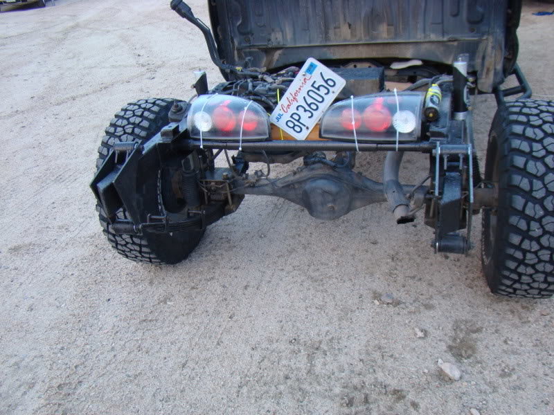

    It was mid build. Did you notice the 90* gusset shackles? How about the 2x4 the plate is screwed on to? lol

    36,723
    Yeah! Those are a bit odd. haha

    Trailer park fab. Don't judge me because I like to party.
