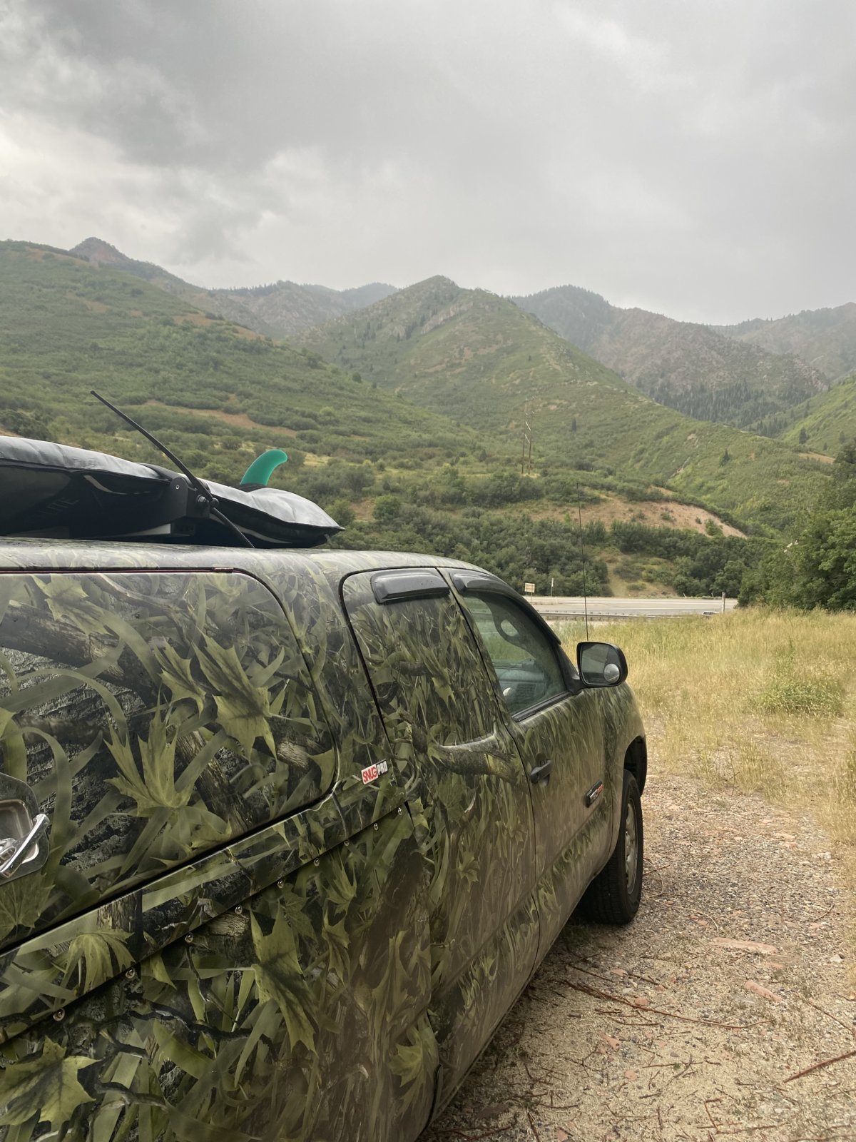

    After adding a snugpro, deep cycle, dive gear & carpet bed kit, my trucks rear end sits too low. Is there an easy & inexpensive way to lift my rear end afew inches? Pinion angle repercussions after 3"...?

    How do you not lose that thing if you park it in the woods?

    I just a see mountain and a field, what am I supposed to be looking at??
