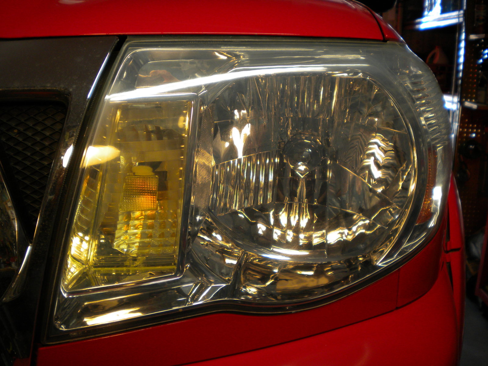

    I use Xpel uv protective film. Installed it on my 07 when new. This is what they looked like after 16 years. Granted the truck is low milage (right now at 35,600 miles) but over half those years the truck was parked outside every day in the sun. These headlights had never had any headlight restoration products applied to them... just started to show some haze the last few years.
    Back then the film was alot thicker. Just upgraded to new lights and installed the Xpel film on them... half the thickness now but alot easier to work with.
