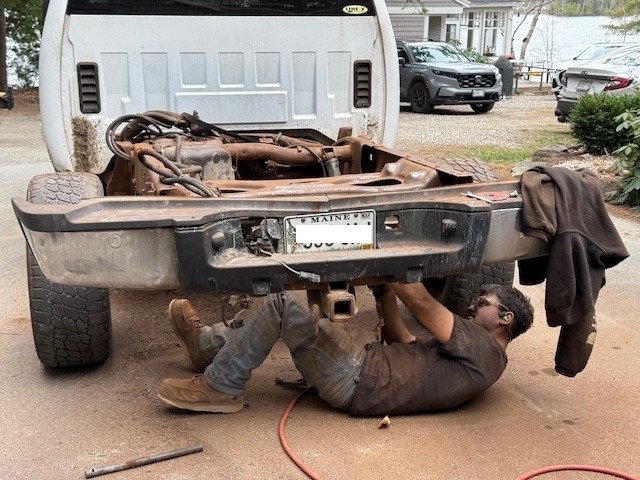

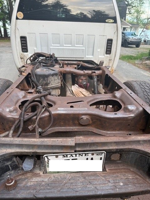

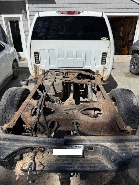

    Short of dry ice or sand blasting, there's grinding, sanding, needle scaling and a lot of elbow grease. Then a coating of some rust preventer like POR-15

    After removing the rust from the back of a truck frame we pressure washed it then sprayed it with POR-15 Rust Remover and let it sit for 20-30 min. After that we pressure washed the frame again and then let it dry for a couple days prior to coating it with POR-15 Rust Prevent. I'm not trying to advocate for POR. It's what we could find in our local stores. Once all is done the intent is to Fluid Film. I normally work with the regular FF, but I know they make a black FF.
    I guess it depends on how big of an area you are dealing with.
    My son's Duramax project yielded three 5-gallon buckets of rust swept up from the driveway and that's just from just the back end of the truck. We're just starting to deal with under the cab.
