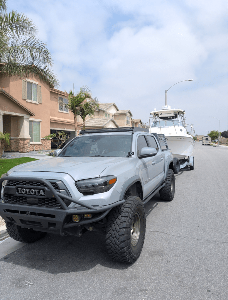

    Road Active Suspension. Research the system, it lives up to the hype. Smooth and compliant with no load, cuts the sag and sway with a load. I love mine. No interference off road.
