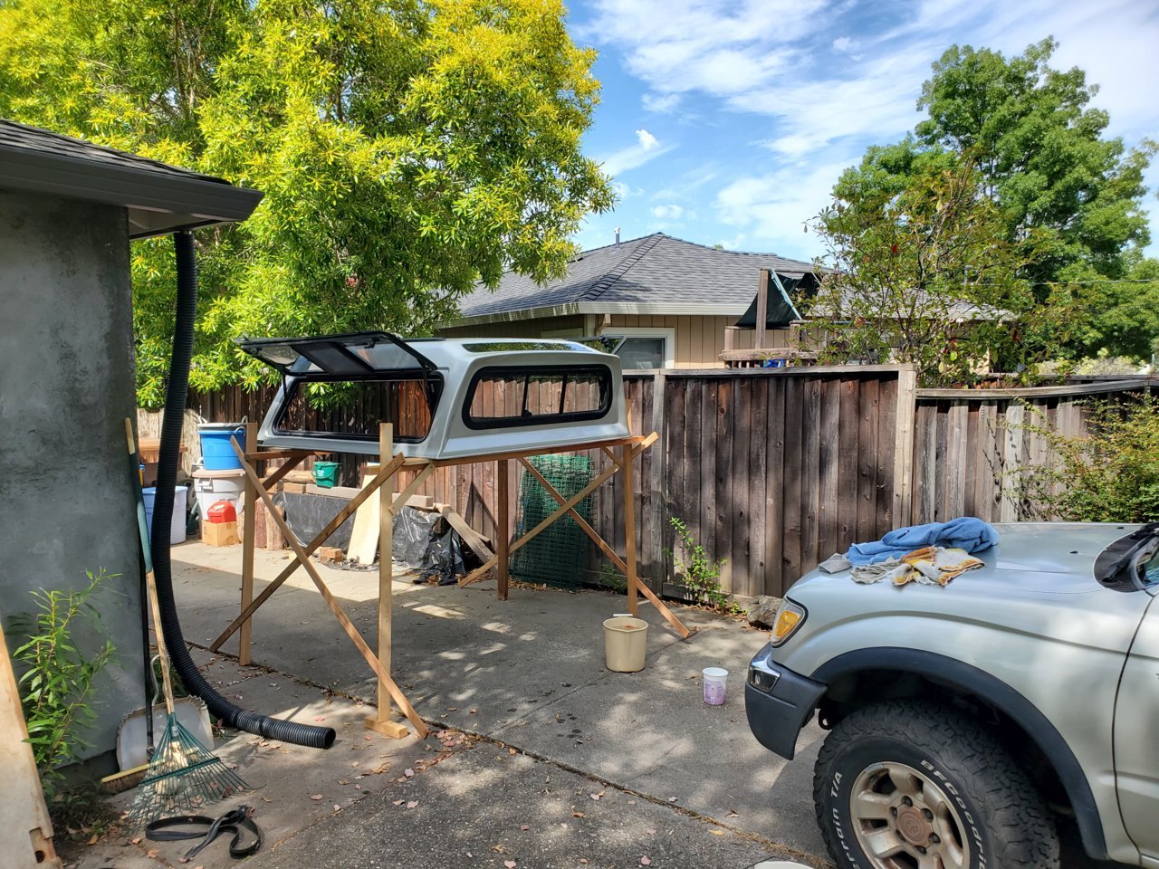

    I just redid mine as well. I second the remarks about using the double bead edpm seal. Since I live in CA I had to test with a hose, lol. I guess I'll see this winter if it's OK.
    I spent a lot of time cleaning since the shell was on there for over 15 years. I've redone my window seals but need to replace the gaskets on the sliding windows. 20230716_155748.jpg
