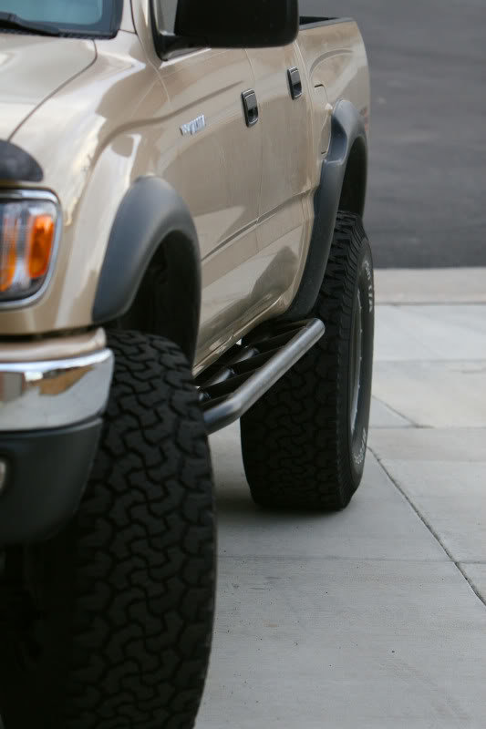

    TRD cat back exhaust, rain visors, limo tent on back pasenger windows and 35 percent added to back factory tint window. 35 on front driver and pasenger side. Sport pedals, all weather fl mats, roof rack, front skid plate , BFG ALL TERAINS including spare. ALL installed by dealer.
    I cleaned, primed and painted them today. Having them welded on in the morning. Will post pics. Taking your pics in to show the welder just for reference. :cool:

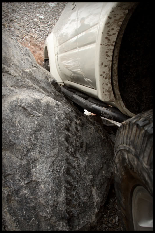

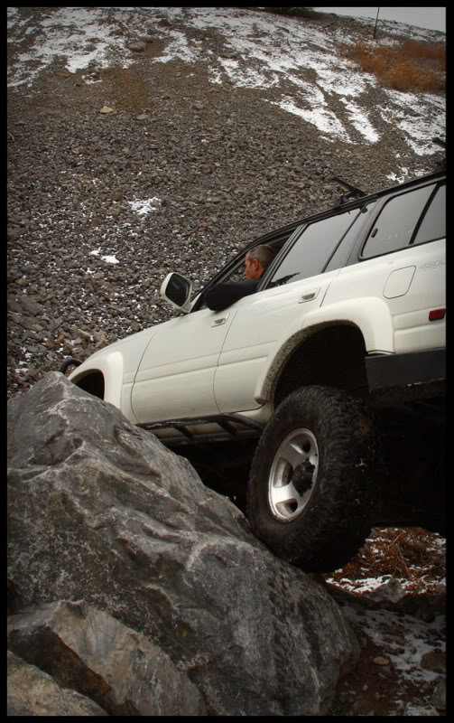

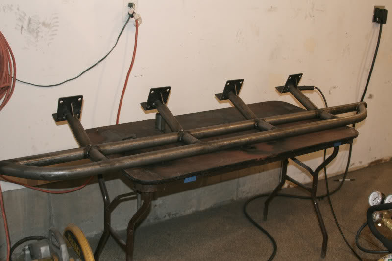

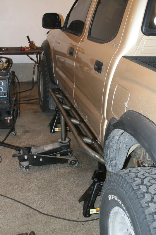

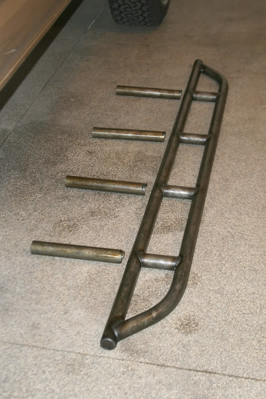

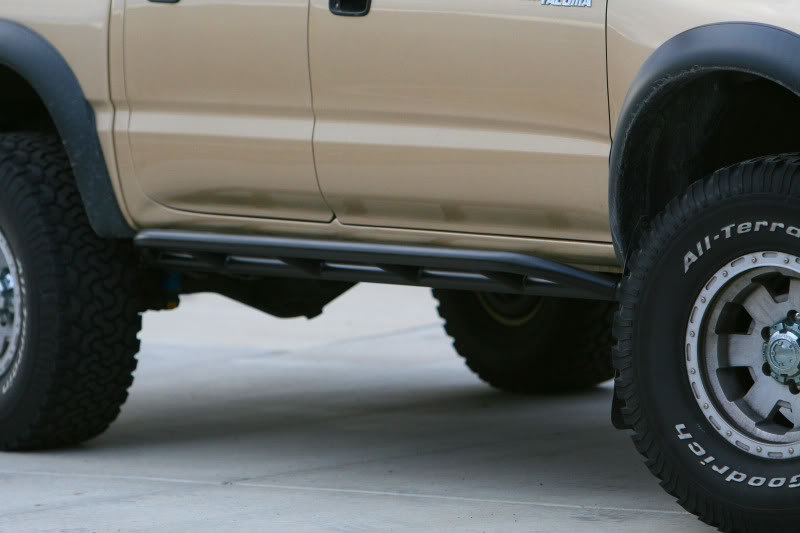

    I'm using the weld-on slider from Trail-Gear. One of the least expensive options out there. I just put a set on my Tacoma after almost 3 years of having a set of them on my Land Cruiser. I've dropped hard onto them in my cruiser numorous times, used them to pivot the entire truck many times, used them to slide over very large boulders with nearly the full weight of the truck on them. Not a single bend in the HREW after all of that. I figure if they hold up that well under my heavy cruiser they'll do just fine on my lighter Tacoma that likely won't be wheeled as hard.
    These are the 67" ones from Trail-Gear on my Land Cruiser. 3 legs and gussets at the frame
    78" ones for my DC Tacoma being put together. 4 legs with frame plates and gussets.
