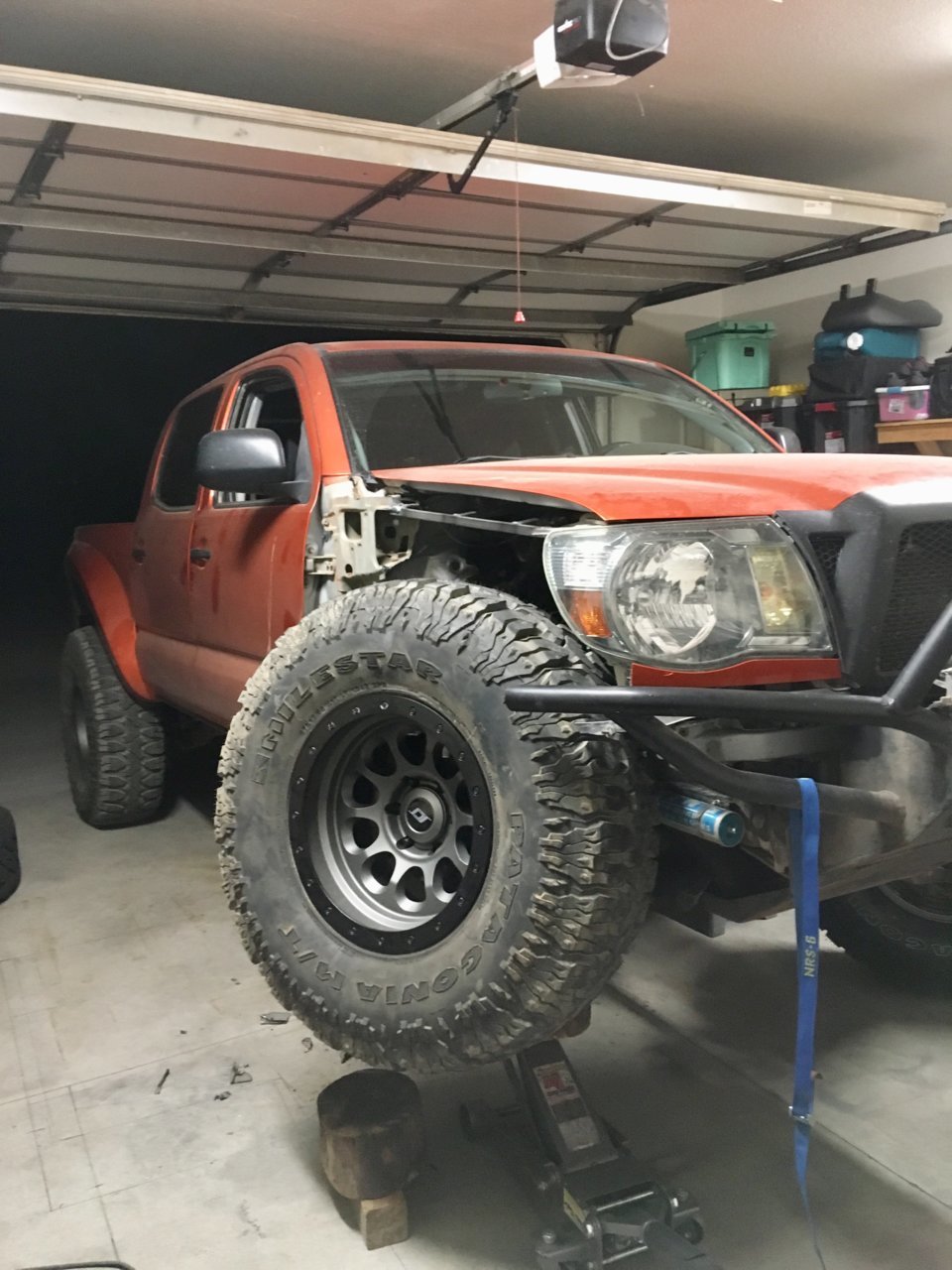

    If you want to ditch the wheel spacers and maintain that stance you’ll need something with a 3.5” backspacing. I went with SCS Ray 10 recently and love them. I believe they offer a few of their wheels in a 17”x9” with 3.5” bs.
    You’ll need a cab mount chop with that size tire regardless.
    As for your lift goes, ditch the top plate spacer and run either a stiffer spring or more preload if possible to achieve the ride height you want.
    Don’t run the diff drop, it does nothing but give you lower ground clearance.
    And with that much lift you’ll want to look into at least some upper control arms to help your alignment. My suggestion is dirt king or total chaos.
    Here’s the rims for reference.
